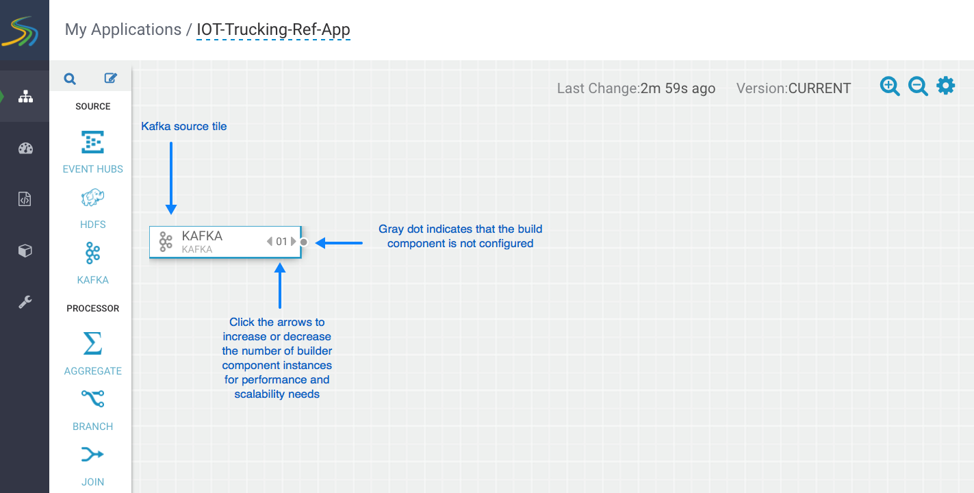

  1. Drag the Kafka builder component onto the canvas, creating a Kafka tile:
  2. Set the number of run-time instances for your Kafka tile component by clicking the up arrow on the tile.

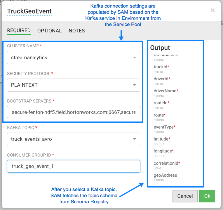

  3. Double-click on the tile to begin configuring Kafka. After you specify a Kafka topic name, SAM communicates with the Schema Registry and displays the schema:

Once you have configured your Kafka component correctly, the tile component displays a green dot.
