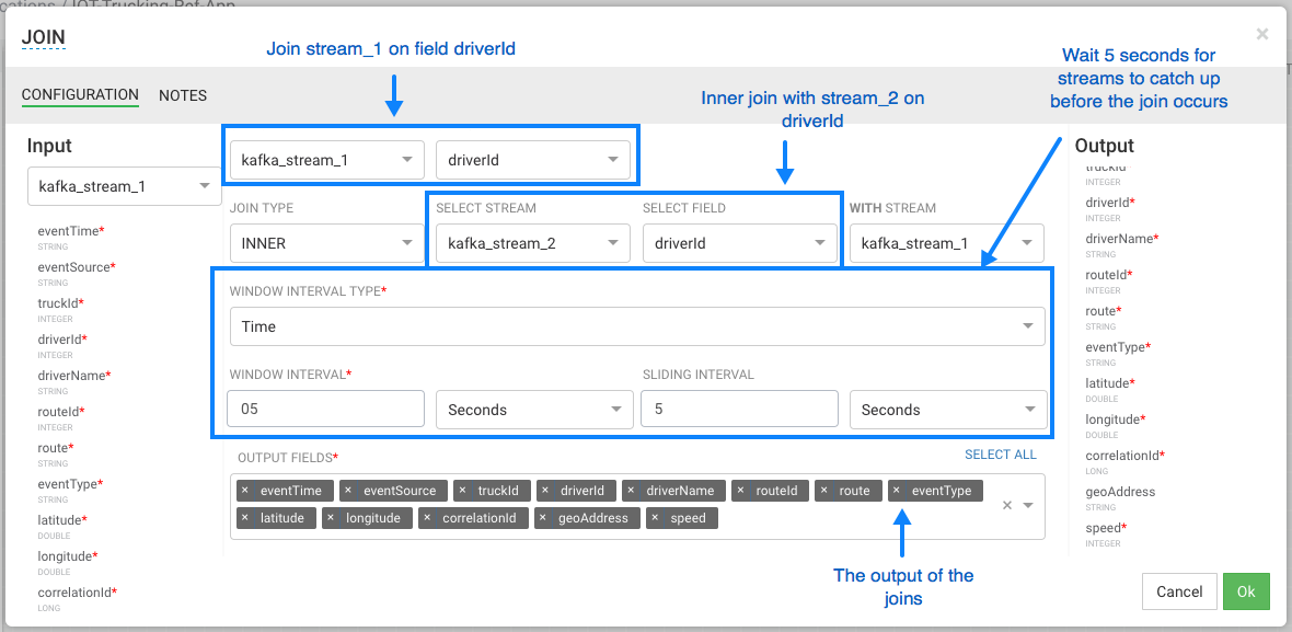

Joining multiple streams is an important SAM capability. You accomplish this by adding the Join processor to your strream application.
This section shows you how to configure a Join processor that joins the truck geo-event stream with the speed event stream, based on Requirement 5 of the use case.
Steps
  1. Drag a Join processor onto your canvas and connect it to a source.
  2. Double click the Join tile to open the Configuration dialog.
  3. Configure the Join processors according to the example below.
Example
