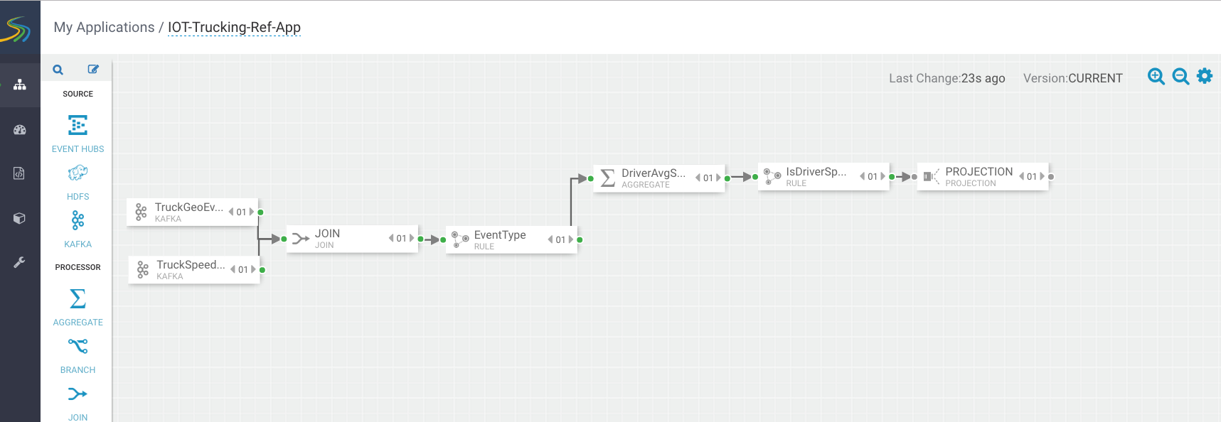

  1. Drag the Projection processor onto the canvas and connect to it to the IsDriverSpeeding Rule processor:

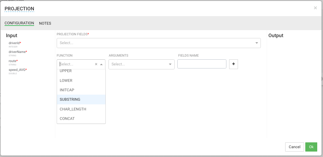

  2. When you double click on the projection processor, you will see a number of out of the box functions however a Round function does not exist.

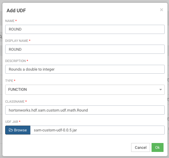

    2. Select the UDF tab and click the + sign to create the ROUND UDF. The jar for this UDF can be downloaded from here. The simple java class used to implement this Round function using the SAM SDK can be found here. Unzip the downloaded artifact and use the jar called sam-custom-udf-0.0.5.jar. Configure the UDF with the following values:

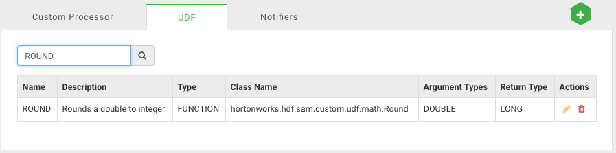

    3. After uploading the UDF, you should see the new Round UDF created.

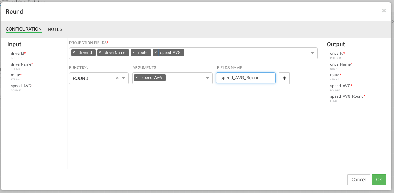

  4. After creating the UDF, go back to your Application and double click on the on the Projection Processor you added to the canvas and you see ROUND in the FUNCTION drop down list. Configure the ROUND function as the following:
