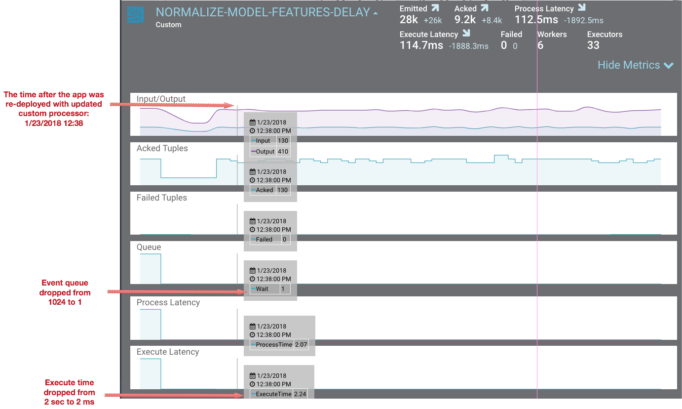

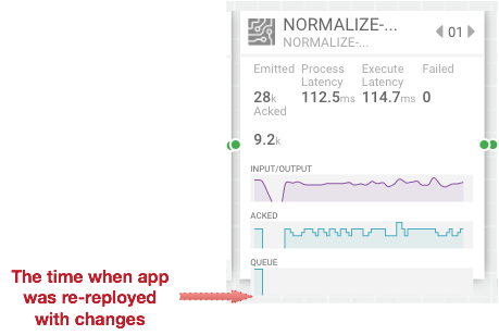

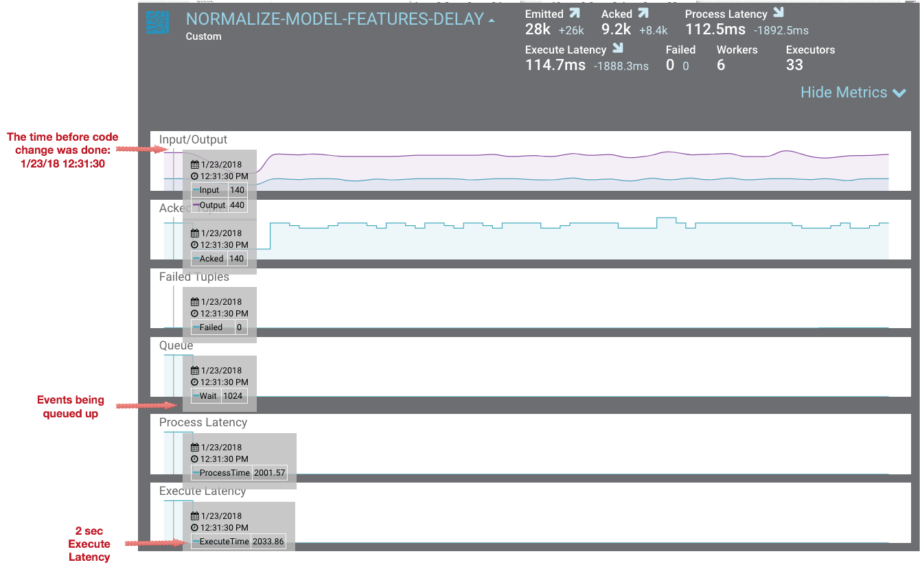

​Latency Improvements

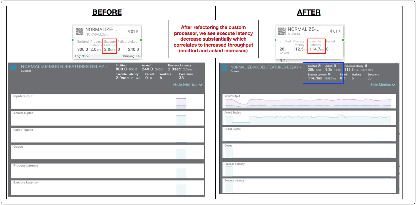

The below is the before and after metrics for the NORMALIZE-MODEL-FEATURES custom processor.
In the metric details view, the graphs provides an easy way to compare metrics before and after the code change.
You can also select the Metrics tab to validate the performance improvement.
If you zoom in on the NORMALIZE-MODEL-FEATURES component, you will see that after the code change is made, throughput increases and the wait drops to 0.
