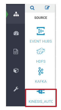

  7. On the SAM Application Canvas Palette, you should now see KINESIS source.

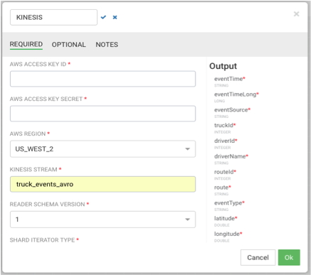

  8. Dragging the kinesis source onto the canvas and double clicking it, you should see the following kinesis dialog. The dialog properties comes from the topologyComponentBundle flux config you used to register the custom source.
