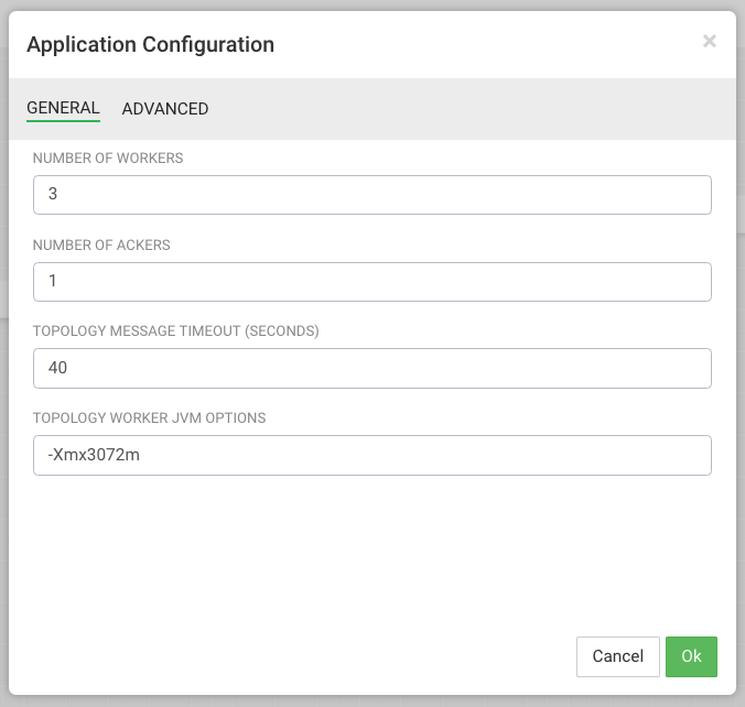

Before deploying the application, you must configure deployment settings such as JVM size, number of ackers, and number of workers. Because this topology uses a number of joins and windows, you should increase the JVM heap size for the workers.
Steps
  1. Click the gear icon at the top right corner of the canvas to display the Application Configuration dialog.
  2. Increase Number of Workers to 5.
  3. Set Topology Worker JVM Options to -Xmx3072m.
Example

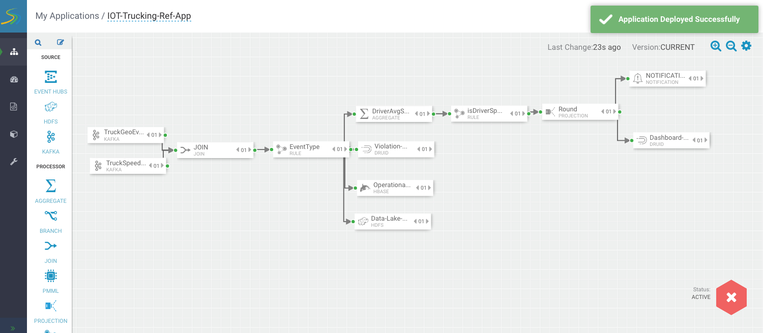

​Deploy the App
After you have configure the application's deployment settings, click the Deploy button at the lower right of the canvas.

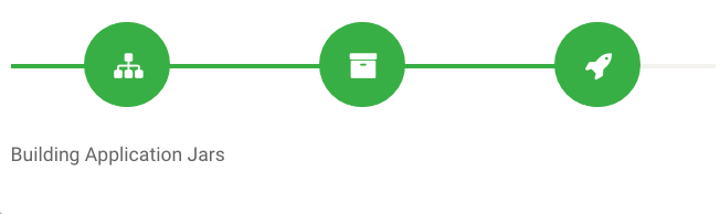

During the deployment process, Streaming Analytics Manager completes the following tasks:
  1. Construct the configurations for the different big data services used in the stream app.
  2. Create a deployable jar of the streaming app.
  3. Upload and deploy the app jar to streaming engine server.
As SAM works through these tasks, it displays a progress bar.
The stream application is deployed to a Storm cluster based on the Storm Service defined in the Environment associated with the application.
After the application has been deployed successfully, SAM notifies you and updates the button to red to indicate it is deployed. Click the red button to kill/undeploy the app.
