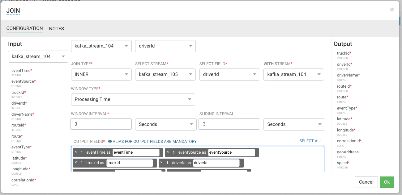

  1. Drag a Join processor onto your canvas and connect it to a source.
  2. Double-click the Join tile to open the Configuration dialog.
  3. Configure the Join processors according to the example below.
