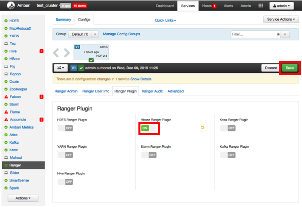

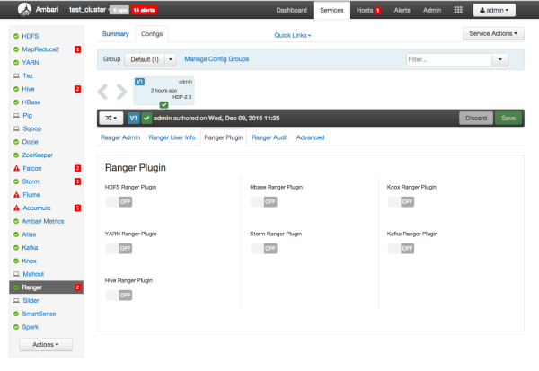

  1. On the Ranger Configs page, select the Ranger Plugin tab.
  2. Under HBase Ranger Plugin, select On, then click Save in the black menu bar.

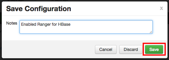

  3. A Save Configuration pop-up appears. Type in a note describing the changes you just made, then click Save.

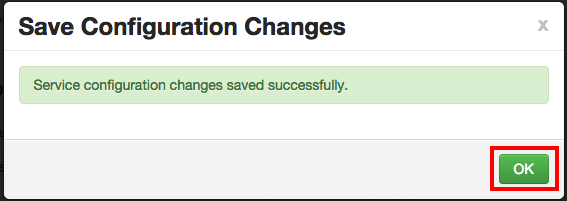

  5. Click OK on the Save Configuration Changes pop-up.

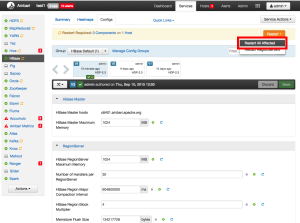

  6. Select HBase in the navigation menu, then select Restart > Restart All Affected to restart the HBase service and load the new configuration.

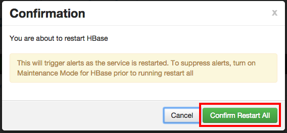

  7. Click Confirm Restart All on the confirmation pop-up to confirm the HBase restart.
  8. After HBase restarts, the Ranger plugin for HBase will be enabled.
