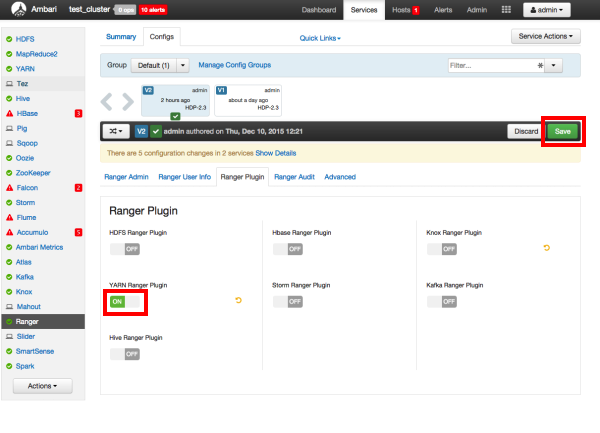

  1. On the Ranger Configs page, select the Ranger Plugin tab.
  2. Under YARN Ranger Plugin, select On, then click Save in the black menu bar.

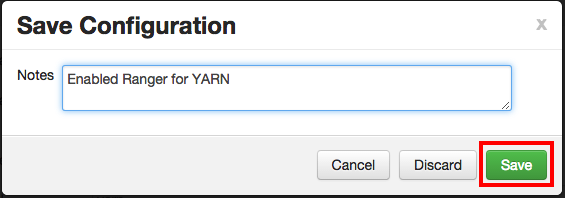

  3. A Save Configuration pop-up appears. Type in a note describing the changes you just made, then click Save.

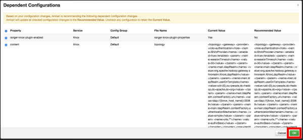

  4. A Dependent Configuration pop-up appears. Click OK to confirm the configuration updates.
  5. Click OK on the Save Configuration Changes pop-up.

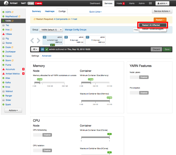

  6. Select YARN in the navigation menu, then select Restart > Restart All Affected to restart the YARN service and load the new configuration.

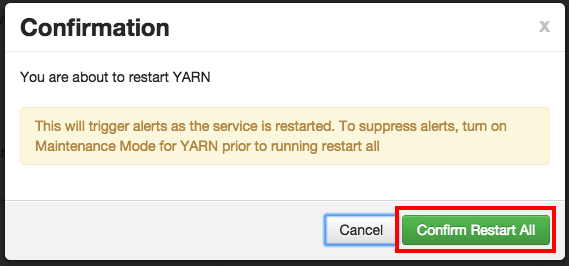

  7. Click Confirm Restart All on the confirmation pop-up to confirm the YARN restart.
