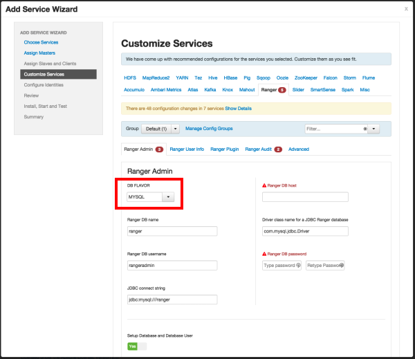

  1. On the Customize Services page, select the Ranger Admin tab, then use the DB Flavor drop-down to select the database type that you are using with Ranger.

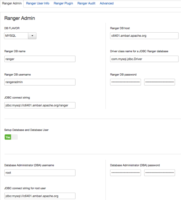

    MySQL

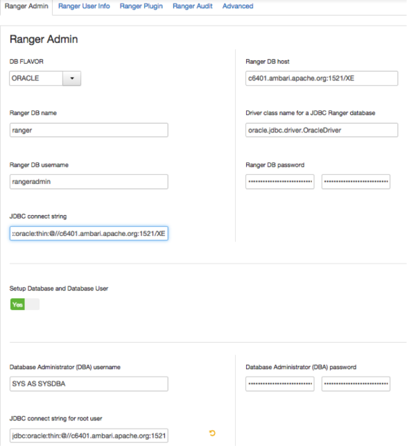

    Oracle -- if the Oracle instance is running with a Service name.

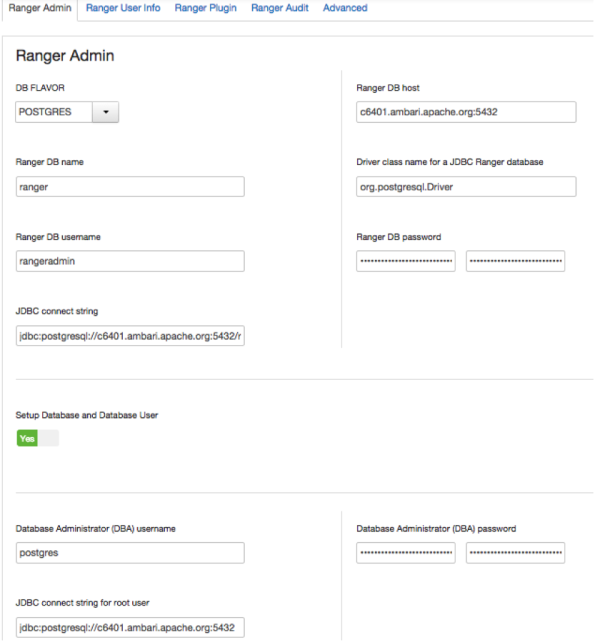

    PostgreSQL

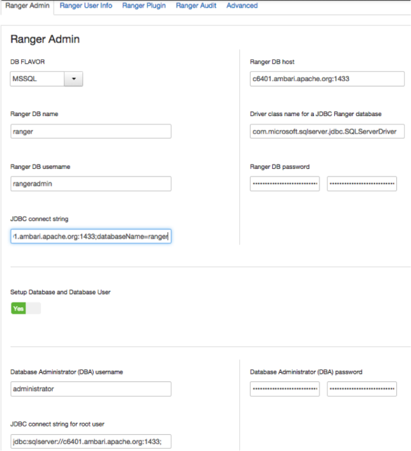

    MS SQL

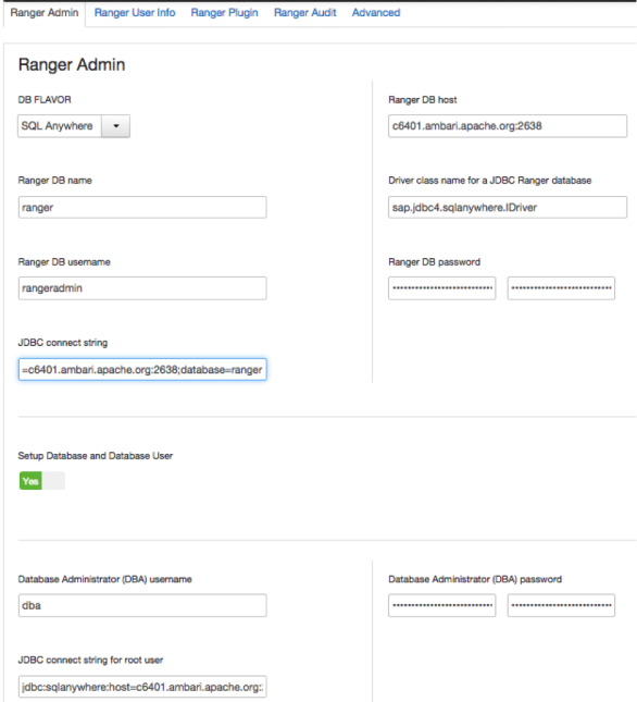

    SQL Anywhere
