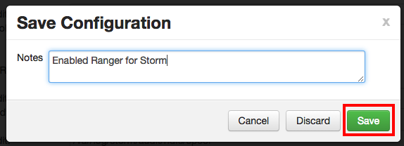

  3. A Save Configuration pop-up appears. Type in a note describing the changes you just made, then click Save.

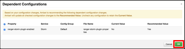

  4. A Dependent Configuration pop-up appears. Click OK to confirm the configuration updates.
  5. Click OK on the Save Configuration Changes pop-up.

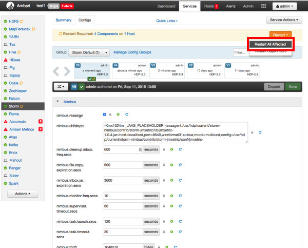

  6. Select Storm in the navigation menu, then select Restart > Restart All Affected to restart the Storm service and load the new configuration.

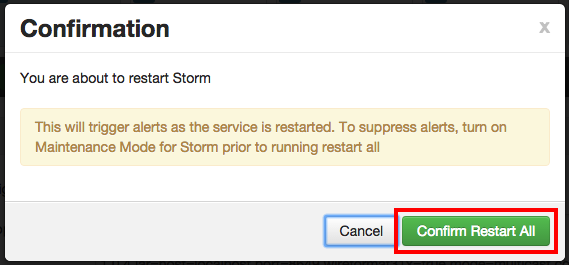

  7. Click Confirm Restart All on the confirmation pop-up to confirm the Storm restart.
  8. After Storm restarts, the Ranger plugin for Storm will be enabled.
