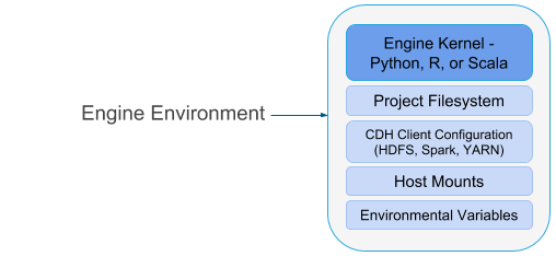

The term engine refers to a virtual machine-style environment that is created when you run a project (via session or job) in Cloudera Data Science Workbench. You can use an engine to run R, Python, and Scala workloads on data stored in the underlying CDH cluster.
Cloudera Data Science Workbench allows you to run code in one of two ways, using either a session or a job. A session is a way to interactively launch an engine and execute code, whereas a job lets you batch process those actions and can be scheduled to run recursively. Each session and job launches its own engine that lives as long as the workload is running (or until it times out).
A running engine will include the following components:
- Kernel
Each engine runs a kernel with either an R, Python or Scala process that can be used to execute code within the engine. The kernel launched differs based on the option (either Python 2/3, PySpark, R, or Scala) you select when you launch the session or configure a job.
The Python kernel is based on the Jupyter IPython kernel, the R kernel has been custom-made for CDSW, and the Scala kernel is based on the Apache Toree kernel.
- Project Filesystem Mount
Cloudera Data Science Workbench uses a persistent filesystem to store project files such as user code, installed libraries, or even small data files. Project files are stored on the master node at /var/lib/cdsw/current/projects.
Every time you launch a new session or run a job for a project, a new engine is created and the project filesystem is mounted into the engine's environment (at /home/cdsw). Once the session/job ends, the only project artifacts that remain are a log of the workload you've run, and any files that were generated or modified, including any libraries you might have installed. All of the installed dependencies will persist through the lifetime of the project. The next time you launch a session/job for the same project, those dependencies will be mounted into the engine environment along with the rest of the project filesystem.
- CDH and Host Mounts
To ensure that each engine is able to access the CDH cluster, a number of folders are mounted from the CDSW gateway host into the engine's environment. For example, on a CSD deployment, this includes the path to the parcel repository, /opt/cloudera, client configurations for HDFS, Spark, YARN, as well as the host’s JAVA_HOME.
Cloudera Data Science Workbench works out-of-the-box for CDH clusters that use the default file system layouts configured by Cloudera Manager. If you have customized your CDH cluster's filesystem layout (for example, modified the CDH parcel directory) or if there are any other files on the hosts that should be mounted into the engines, use the Site Administration panel to include them.
