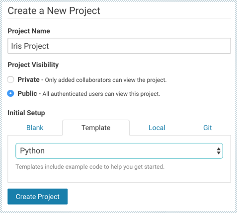

Create a Project
The scripts we require for this example are available in the Python template project that ships with Cloudera Data Science Workbench. So first, create a new project from the Python template:

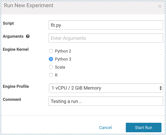

Click Run Experiment.
Fill out the form as follows and click Start Run. Make sure you use the Python 3 kernel.
The new experiment should now show up on the Experiments table. Click on the Run ID to go to the experiment's Overview page. The Build and Session tabs display realtime progress as the experiment builds and executes.

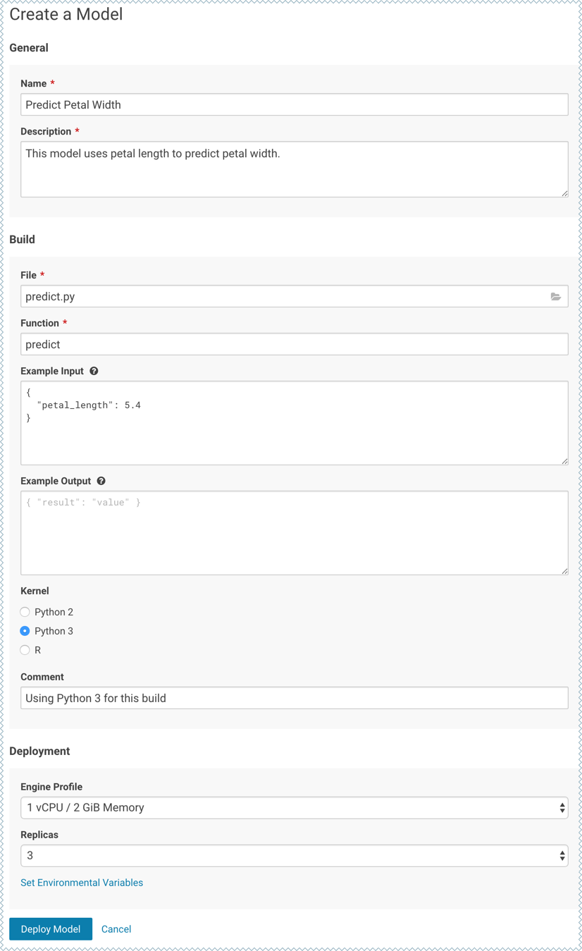

Click New Model and fill out the fields. Make sure you use the Python 3 kernel. For example:
Click on the model to go to its Overview page. As the model builds you can track progress on the Build page. Once deployed, you can see the replicas deployed on the Monitoring page.

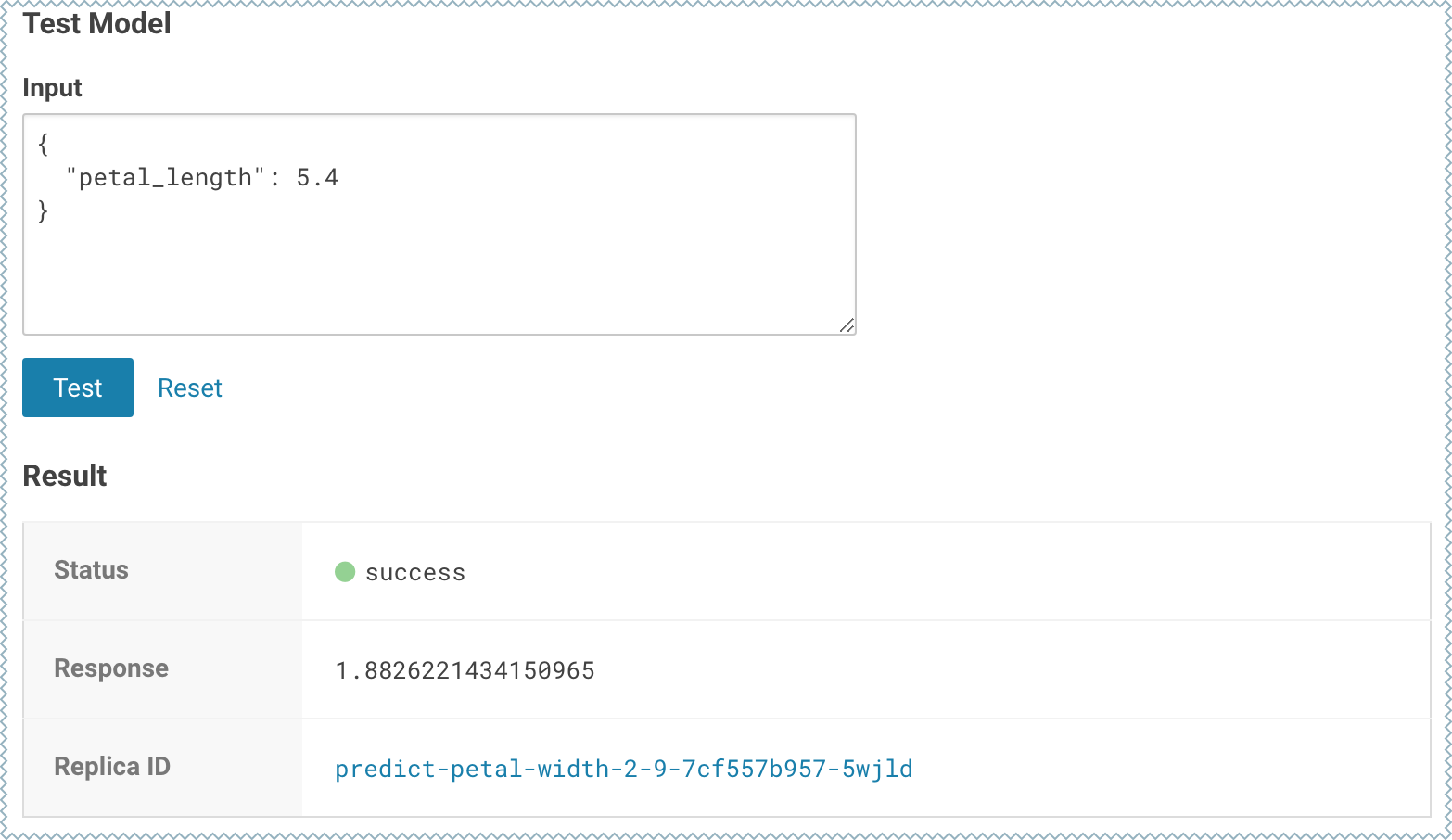

To test the model, use the Test Model widget on the model's Overview page.
