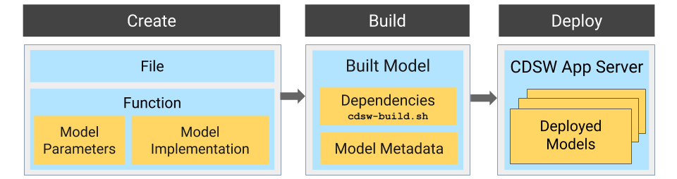

Stages of the Model Deployment Process
- Create
- File - The R or Python file containing the function to be invoked when the model is started.
- Function - The function to be invoked inside the file. This function should take a single JSON-encoded object (for example, a python dictionary) as input
and return a JSON-encodable object as output to ensure compatibility with any application accessing the model using the API. JSON decoding and encoding for model input/output is built into Cloudera
Data Science Workbench.
The function will likely include the following components:
- Model Implementation
The code for implementing the model (e.g. decision trees, k-means). This might originate with the data scientist or might be provided by the engineering team. This code implements the model's predict function, along with any setup and teardown that may be required.
- Model Parameters
A set of parameters obtained as a result of model training/fitting (using experiments). For example, a specific decision tree or the specific centroids of a k-means clustering, to be used to make a prediction.
- Build
This stage takes as input the file that calls the function and returns an artifact that implements a single concrete model, referred to as a model build.
- Built Model
A built model is a static, immutable artifact that includes the model implementation, its parameters, any runtime dependencies, and its metadata. If any of these components need to be changed, for example, code changes to the implementation or its parameters need to be retrained, a new build must be created for the model. Model builds are versioned using build numbers.
To create the model build, Cloudera Data Science Workbench creates a Docker image based on the engine designated as the project's default engine. This image provides an isolated environment where the model implementation code will run.
To configure the image environment, you can specify a list of dependencies to be installed in a build script called cdsw-build.sh.
For details about the build process and examples on how to install dependencies, see Engines for Experiments and Models. - Build Number:
Build numbers are used to track different versions of builds within the scope of a single model. They start at 1 and are incremented with each new build created for the model.
- Built Model
- Deploy
This stage takes as input the memory/CPU resources required to power the model, the number of replicas needed, and deploys the model build created in the previous stage to a REST API.

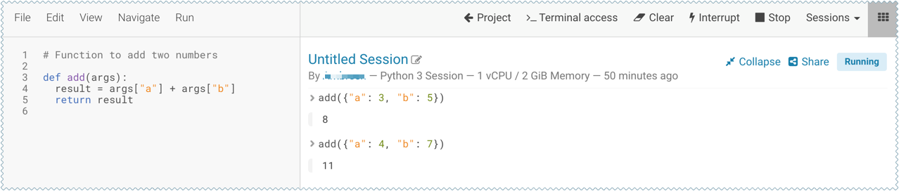

- Click Open Workbench and launch a new Python 3 session.
- Create a new file within the project called add_numbers.py. This is the file where we define the function that will be called when the model is run. For
example:
add_numbers.py
def add(args): result = args["a"] + args["b"] return result
Before deploying the model, test it by running the add_numbers.py script, and then calling the add function directly from the interactive workbench session. For example:
add({"a": 3, "b": 5})

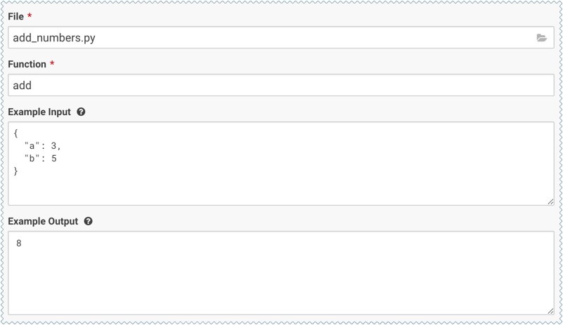

- Give the model a Name and Description.
Enter details about the model that you want to build. In this case:
- File: add_numbers.py
- Function: add
- Example Input: {"a": 3, "b": 5}
- Example Output: 8

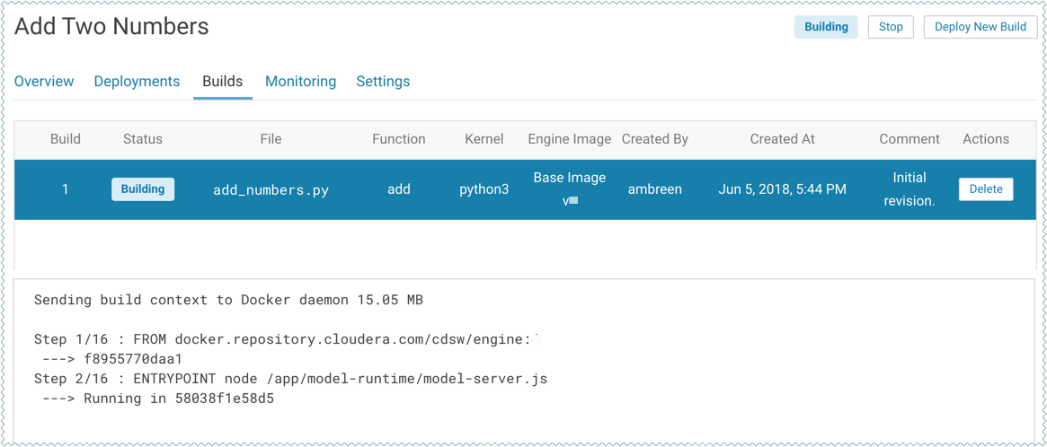

Click on the model to go to its Overview page. Click Builds to track realtime progress as the model is built and deployed. This process essentially creates a Docker container where the model will live and serve requests.

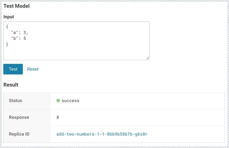

Once the model has been deployed, go back to the model Overview page and use the Test Model widget to make sure the model works as expected.
If you entered example input when creating the model, the Input field will be pre-populated with those values. Click Test. The result returned includes the output response from the model, as well as the ID of the replica that served the request.

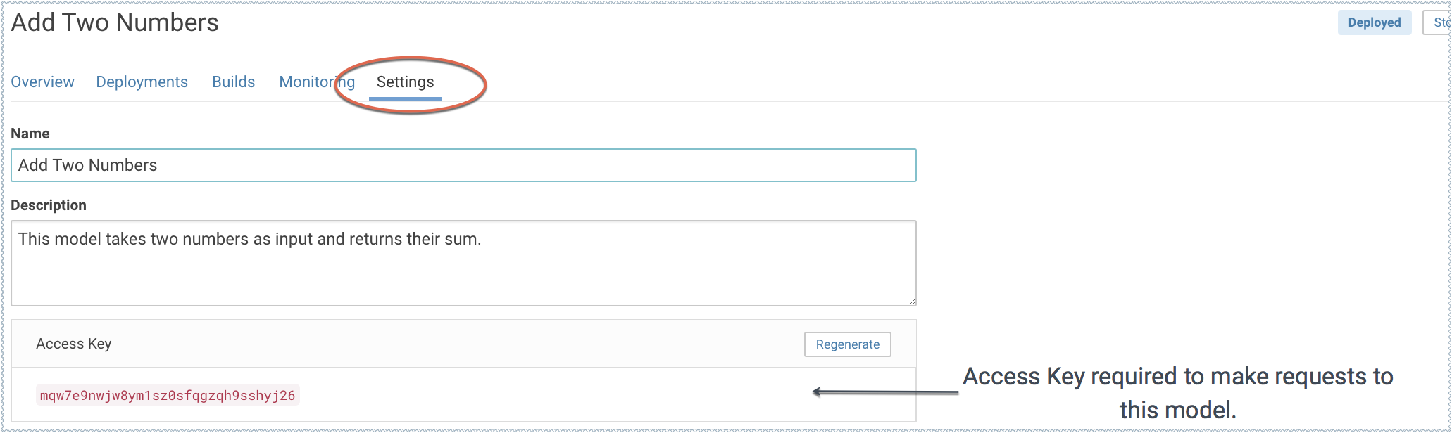

(Requirement) Access Key
Each model in Cloudera Data Science Workbench has a unique access key associated with it. This access key serves two purposes: 1) it is a unique identifier for the model, and 2) it serves as an authentication token that allows you to make calls to the model.
Models deployed using Cloudera Data Science Workbench are not public. In order to call an active model your request must include the model's access key for authentication (as demonstrated in the sample calls above).
To locate the access key for a model, go to the model Overview page and click Settings.

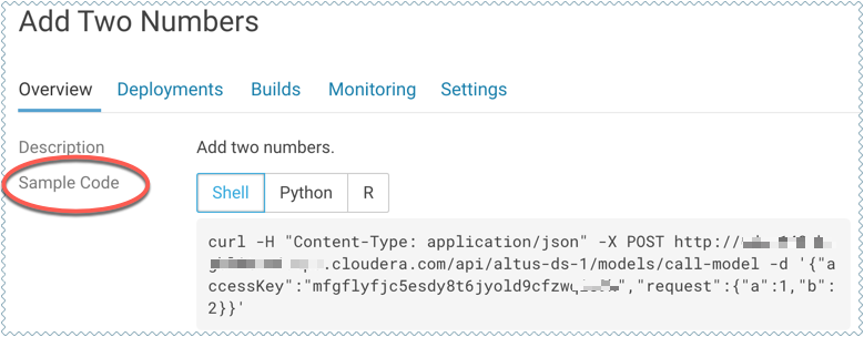

Test Model Widget
On each model's Overview page, Cloudera Data Science Workbench provides a widget that makes a sample call to the deployed model to ensure it is receiving input and returning results as expected.

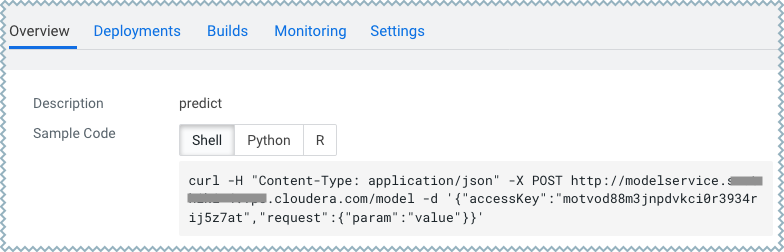

Sample Request Strings
On the model Overview page, Cloudera Data Science Workbench also provides sample curl and POST request strings that you can use to test calls to the model. Copy/paste the curl request directly into a Terminal to test the call.
Note that these sample requests already include the example input values you entered while building the model, and the access key required to query the model.

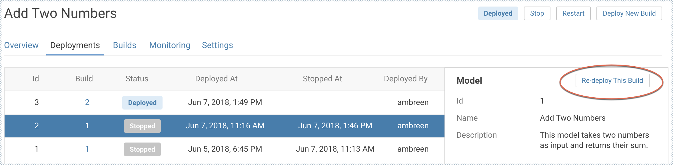

Re-deploy an Existing Build
- An active model that previously requested a large number of CPUs/GPUs that are not being used efficiently.
- An active model that is dropping requests because it is falling short of replicas.
- An active model needs to be rolled back to one of its previous versions.
- Go to the model Overview page.
- Click Deployments.
Select the version you want to deploy and click Re-deploy this Build.
- Modify the model serving environment as needed.
- Click Deploy Model.

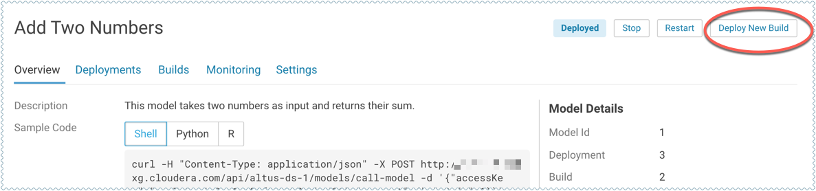

Deploy a New Build for a Model
- Code changes to the model implementation.
- Renaming the function that is used to invoke the model.
Click Deploy New Build.
- Complete the form and click Deploy Model.
