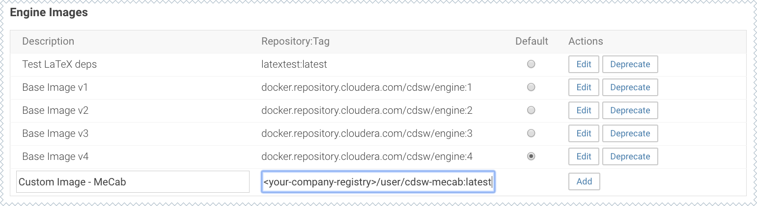

- Whitelist Image for the Deployment
First, a site administrator will need to clear the new image for use on the deployment.
- Log in as a site administrator.
- Click .
- Add <company-registry>/<user-name>/<image-name>:<tag> to the list of whitelisted engine images.

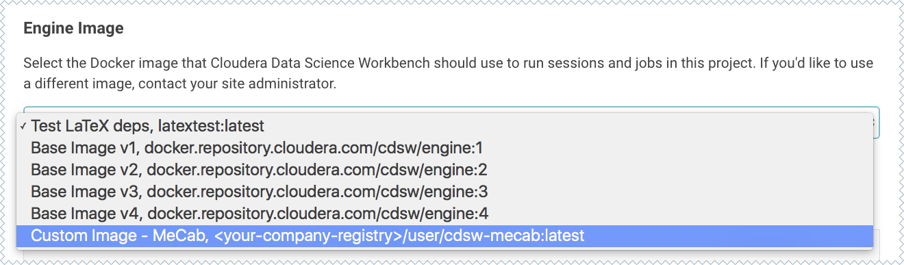

If you want to start using the image in a project, the project administrator will need to set this image as the default image for the project.
- Go to the project Settings page.
- Click Engines.
- Select the new customized engine from the dropdown list of available Docker images. Sessions and jobs you run in your project will now have access to this engine.

- Whitelist the image, <your-company-registry>/user/cdsw-mecab:latest. Only a site administrator can do this.
Go to and add <company-registry>/user/cdsw-mecab:latest to the list of whitelisted engine images.
Ask a project administrator to set the new image as the default for your project. Go to the project Settings, click Engines, and select company-registry/user/cdsw-mecab:latest from the dropdown.
You should now be able to run this project on the customized MeCab engine.
