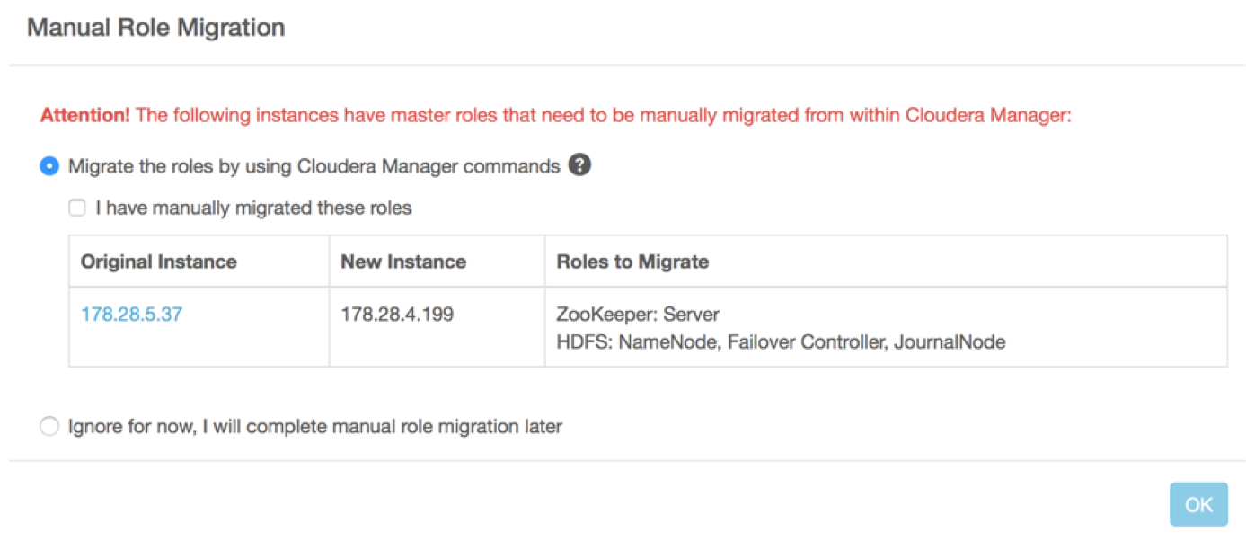

If you have completed Step 1 (on Altus Director) and intend to complete Step 2 (on Cloudera Manager) at a later time, you can confirm which IP address to migrate from or to by going to
the cluster status page in Altus Director and clicking either the link for migration in the upper left, or the Modify Cluster button on the right. A pop-up displays
the hosts to migrate from and to:
You do not need to check the boxes to restart and deploy client configuration at the start of the repair process. You restart and deploy the client configuration manually after role migration is complete.

- Click Details. The message "Attention: Cluster requires manual role migration" is displayed. Click More Details.
- Check the box labeled, "I have manually migrated these roles."
- Click OK.
The failed instance is deleted from the cluster.
