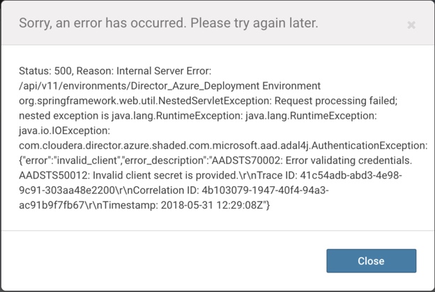

Updating an Expired Azure Client Secret
If your client secret expires, you will get an error in the Altus Director UI similar to the following:
An expired client secret also results in an entry similar to the following in the Altus Director log file:
Failed to authenticate with Azure: java.io.IOException:
com.cloudera.director.azure.shaded.com.microsoft.aad.adal4j.AuthenticationException:
{"error":"invalid_client","error_description":"AADSTS70002: Error validating
credentials. AADSTS50012: Invalid client secret is provided.\r\nTrace ID:
fc5529da-2536-44f6-bad4-d07f6a9bbd00\r\nCorrelation ID:
1e7f12f3-32e7-4635-8b27-197e53fd0ab8\r\nTimestamp: 2018-05-31
11:13:11Z"}Steps to Update an Expired Client Secret
