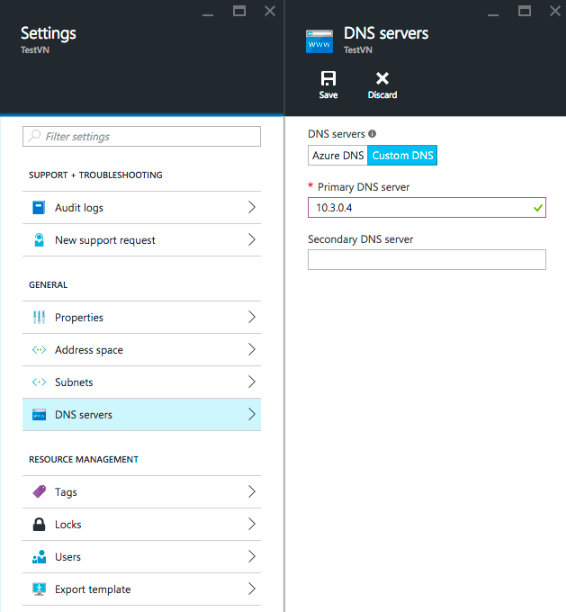

Swapping DNS from Azure to BIND
- In the left pane, click Resource groups.
- Select the resource group your DNS server is in.
- Click on the virtual network your cluster is using.
- Click settings.
- Click DNS servers.
- Set DNS servers to Custom DNS.
- Set Primary DNS server to the private IP address of your Altus Director host (10.3.0.4 in this example).
- Wait for the DNS setting update to complete in the Azure portal, then restart the network service on the VM.
VMs created after the DNS setting is updated in the Azure portal automatically pick up the new DNS server address.
- Restart the network service to pull down the nameserver changes entered in the Azure portal:
service network restart
cat /etc/resolv.confIf the change has not yet propagated, wait two minutes and restart the network service again. You might have to do this multiple times.
