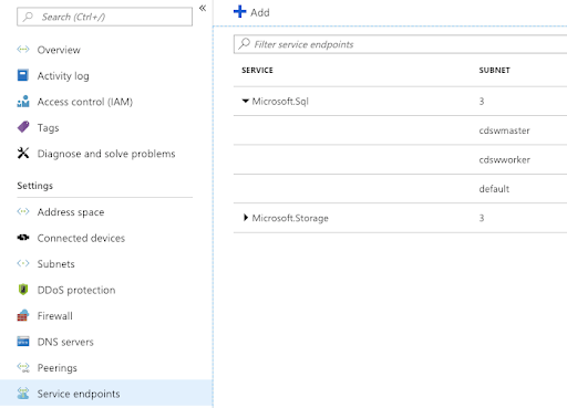

Configure the VNet and subnets that access the database.
Add the VNets or subnets that will need to access the MySQL instance to the Microsoft.Sql service endpoint.
The following screenshot shows subnets added to the Microsoft.Sql service endpoint:

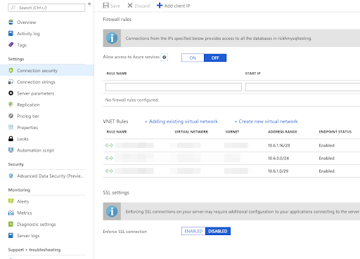

Configure the connectivity for the MySQL instance.
On the Connection security page, set the following properties:
- Allow access to Azure services. Set this property to OFF.
- Enforce SSL connection. Set this property to DISABLED.
Use the Add existing virtual network link to add the VNets or subnets you want to use. You must have configured these VNets and subnets in the previous step.
The following screenshot shows the properties in the Connection security page that you need to set on the Azure portal:

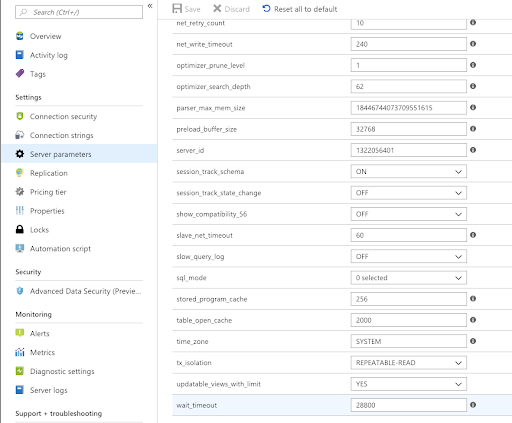

On the Server parameters page, set the wait_timeout property to 28800.
Setting the wait_timeout property to 28800 enables Cloudera Manager and CDH components to re-use existing database connections as expected.
The following screenshot shows the Server parameters page with the wait_timeout property set to 28800:
