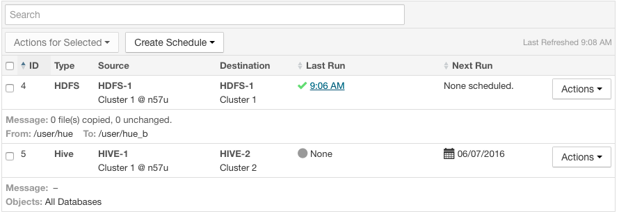

The Replications Schedules page displays a row of information about each scheduled replication job. Each row also displays recent messages regarding the last time the Replication job ran.
Only one job corresponding to a replication schedule can occur at a time; if another job associated with that same replication schedule starts before the previous one has finished, the second one is canceled.
You can limit the replication jobs that are displayed by selecting filters on the left. If you do not see an expected schedule, adjust or clear the filters. Use the search box to search the list of schedules for path, database, or table names.
| Column | Description |
| ID | An internally generated ID number that identifies the schedule. Provides a convenient way to identify a schedule.
Click the ID column label to sort the replication schedule table by ID. |
| Type | The type of replication scheduled, either HDFS or Hive. |
| Source | The source cluster for the replication. |
| Destination | The destination cluster for the replication. |

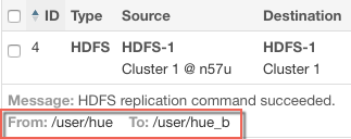

| Objects | Displays on the bottom line of each row, depending on the type of replication:
For example: ![]() |
| Last Run | The date and time when the replication last ran. Displays None if the scheduled
replication has not yet been run. Click the date and time link to view the Replication History page for the replication.
Displays one of the following icons:
Click the Last Run column label to sort the Replication Schedules table by the last run date. |
| Next Run | The date and time when the next replication is scheduled, based on the schedule parameters specified for the schedule.
Hover over the date to view additional details about the scheduled replication.
Click the Next Run column label to sort the Replication Schedules table by the next run date. |
| Actions | The following items are available from the Action button:
- While a job is in progress, the Last Run column displays a spinner and progress bar, and each stage of the replication task is indicated in the message beneath the job's row. Click the Command Details link to view details about the execution of the command.
- If the job is successful, the number of files copied is indicated. If there have been no changes to a file at the source since the previous job, then that file is not copied. As a result, after the initial job, only a subset of the files may actually be copied, and this is indicated in the success message.
- If the job fails, the
icon displays. - To view more information about a completed job, select . See Viewing Replication History.

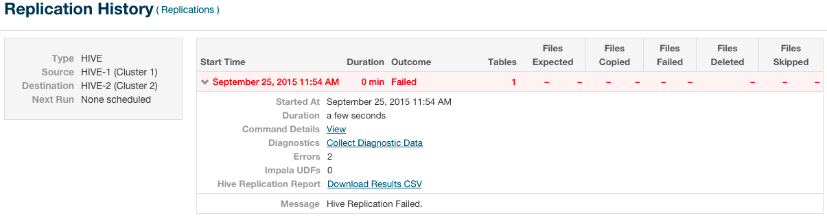

You can view historical details about replication jobs on the Replication History page.
To view the history of a replication job:
- Select to go to the Replication Schedules page.
- Locate the row for the job.
- Click .

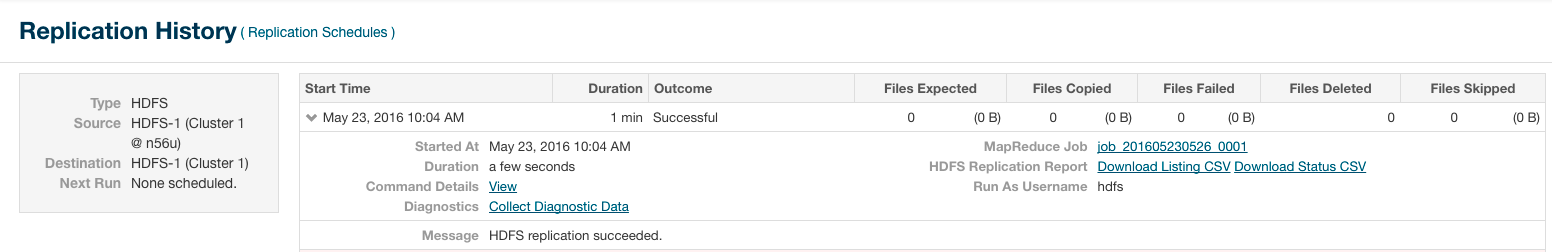

The Replication History page displays a table of previously run replication jobs with the following columns:
| Start Time | Time when the replication job started.
Click
to expand the display and show details of the replication. In this screen, you can:
| Duration | Amount of time the replication job took to complete. |
| Outcome | Indicates success or failure of the replication job. |
| Files Expected | Number of files expected to be copied, based on the parameters of the replication schedule. |
| Files Copied | Number of files actually copied during the replication. |
| Tables | (Hive only) Number of tables replicated. |
| Files Failed | Number of files that failed to be copied during the replication. |
| Files Deleted | Number of files that were deleted during the replication. |
| Files Skipped | Number of files skipped during the replication. The replication process skips files that already exist in the destination and have not changed. |
- Successful. Displays the date and time of the last run replication.
- Failed. Displays the date and time of a failed replication.
- None. This scheduled replication has not yet run.
