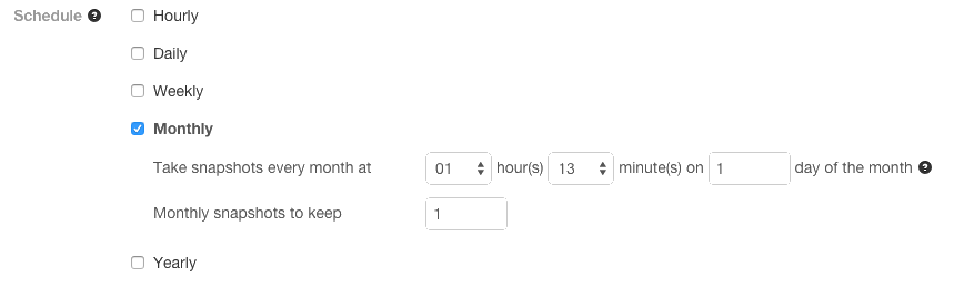

- Specify the snapshot Schedule. You can schedule snapshots hourly, daily, weekly, monthly, or yearly, or any combination of those. Depending on the
frequency you select, you can specify the time of day to take the snapshot, the day of the week, day of the month, or month of the year, and the number of snapshots to keep at each interval. Each
time unit in the schedule information is shared with the time units of larger granularity. That is, the minute value is shared by all the selected schedules, hour by all the schedules for which hour
is applicable, and so on. For example, if you specify that hourly snapshots are taken at the half hour, and daily snapshots taken at the hour 20, the daily snapshot will occur at 20:30.
To select an interval, check its box. Fields display where you can edit the time and number of snapshots to keep. For example:

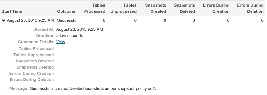

The Snapshots History page displays information about Snapshot jobs that have been run or attempted. The page displays a table of Snapshot jobs with the following columns:
| Column | Description |
| Start Time | Time when the snapshot job started execution.

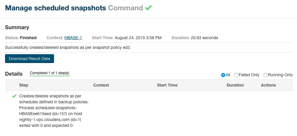

Click ![]() Click the View link to open the Managed scheduled snapshots Command page, which displays details
and messages about each step in the execution of the command. For example:
| Outcome | Displays whether the snapshot succeeded or failed. |
