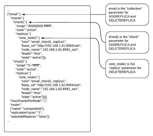

- Use the CLUSTERSTATUS API to retrieve information about the cluster, including current cluster status:
http://192.168.1.81:8983/solr/admin/collections?action=clusterstatus&wt=json&indent=true
Review the returned information to find the correct replica to remove. An example of the JSON file might appear as follows:
- Delete the old replica on origin server using the DELETEREPLICA API:
http://192.168.1.81:8983/solr/admin/collections?action=DELETEREPLICA&collection=email&shard=shard1&replica=core_node2
The DELTEREPLICA call removes the datadir.
