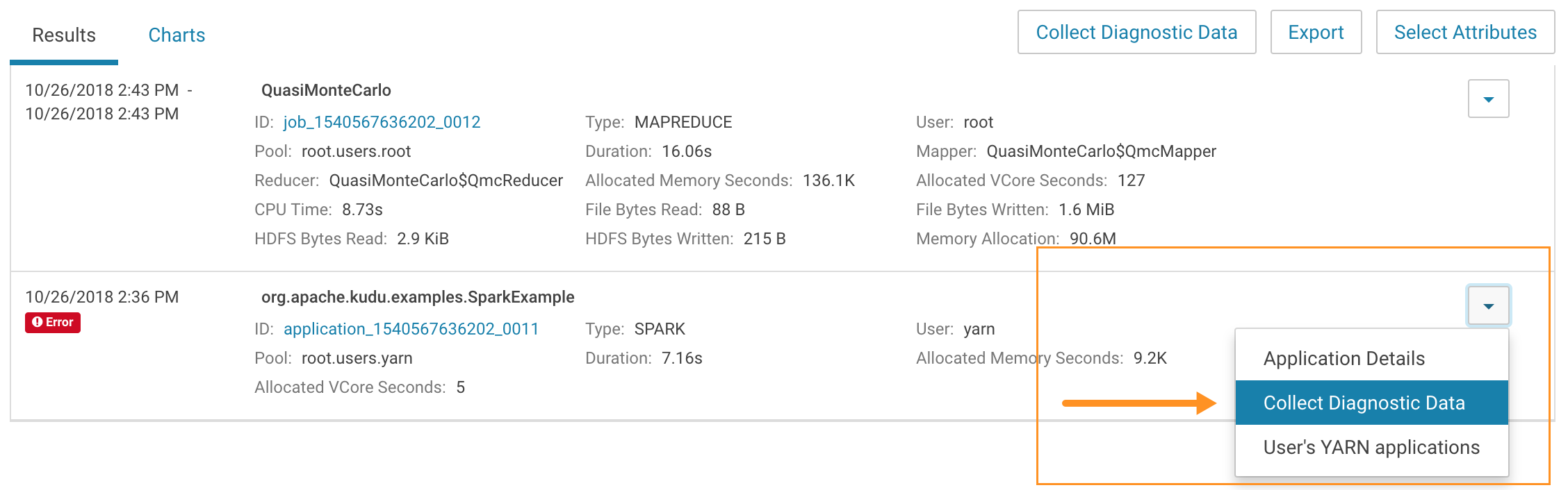

Results Tab

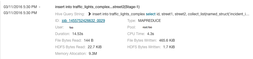

Jobs are ordered with the most recent at the top. Each job has summary and detail information. A job summary includes start and end timestamps, query (if the job is part of a Hive query)
name, pool, job type, job ID, and user. For example:
A running job displays a progress bar under the start timestamp:
to the right of each job listing to do the following. (Not all
options display, depending on the type of job.)
- Application Details – Open a details page for the job.
- Collect Diagnostic Data – Send a YARN application diagnostic bundle to Cloudera support.
- Similar MR2 Jobs – Display a list of similar MapReduce 2 jobs.
- User's YARN Applications – Display a list of all jobs run by the user of the current job.
- View on JobHistory Server – View the application in the YARN JobHistory Server.
- Kill (running jobs only) – Kill a job (administrators only). Killing a job creates an audit event. When you kill a job,
replaces the progress bar. - Applications in Hive Query (Hive jobs only)

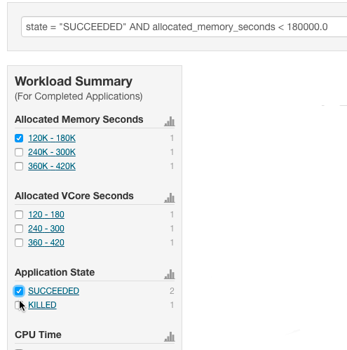

Choosing and Running a Filter
- Do one of the following:
- Select a Suggested or Recently Run Filter
Click the
to the right of the Search button to
display a list of sample and recently run filters, and select a filter. The filter text displays in the text box. - Construct a Filter from the Workload Summary Attributes
Optionally, click Select Attributes to display a dialog box where you can chose attributes to display in the Workload Summary section. Select the checkbox next to one or more attributes and click Close. Only attributes that support filtering appear in the Workload Summary section. See the Attributes table.
The attributes display in the Workload Summary section along with values or ranges of values that you can filter on. The values and ranges display as links with checkboxes. Select one or more checkboxes to add the range or value to the query. Click a link to run a query on that value or range. For example:
- Type a Filter
- Start typing or press Spacebar in the text box. As you type, filter attributes matching the typed letter display. If you press Spacebar, standard filter attributes display. These suggestions are part of typeahead, which helps build valid queries. For information about the attribute name and supported values for each field, hover over the field in an existing query.
- Select an attribute and press Enter.
- Press Spacebar to display a drop-down list of operators.
- Select an operator and press Enter.
- Specify an attribute value in one of the following ways:
- For attribute values that support typeahead, press Spacebar to display a drop-down list of values and press Enter.
- Type a value.
- Click in the text box and press Enter or click Search. The list displays the results that match the specified filter. If the histograms are showing, they are redrawn to show only the values for the selected filter. The filter is added to the Recently Run list.

Examples
Consider the following filter expressions: user = "root", rowsProduced > 0, fileFormats RLIKE ".TEXT.*", and executing = true. In the examples:
- The filter attributes are user, rowsProduced, fileFormats, and executing.
- The operators are =, >, and RLIKE.
- The filter values are root, 0, .TEXT.*, and true.

- From the YARN page in Cloudera Manager, click the Applications menu.
- Collect diagnostics data. There are two ways to do this:
- To collect data from all applications that are visible in the list, click the top Collect Diagnostics Data button on the upper right, above the list of YARN applications.
- To collect data from only one specific application, click the down arrow on the right-hand end of the row of the application and select Collect Diagnostics Data.
- In the Send YARN Applications Diagnostic Data dialog box, provide the following information:
- If applicable, the Cloudera Support ticket number of the issue being experienced on the cluster.
- Optionally, add a comment to help the support team understand the issue.
- Click the checkbox Send Diagnostic Data to Cloudera.
- Click the button Collect and Send Diagnostic Data.
