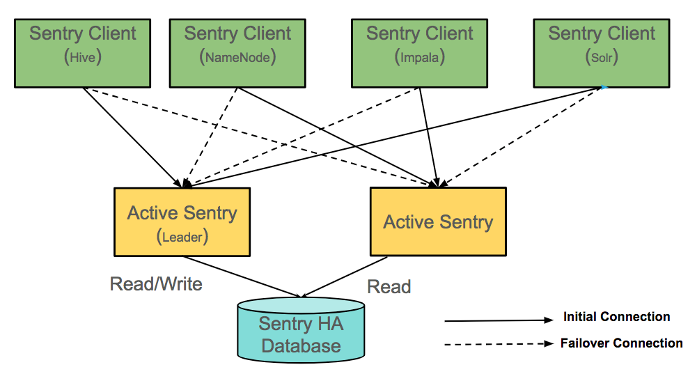

With Sentry high availability enabled, there is a leader Sentry Server that gets the current Hive metadata from the Hive metastore and permissions from HiveServer2, and writes that information to the Sentry database. The other Sentry Server then asks the Sentry database for the updated information; the Sentry Servers do not communicate with each other directly. The Sentry Server leader is determined randomly by the ZooKeeper service and is not configurable by the administrator. If the Sentry Server leader goes down, the other Sentry Server becomes the leader. Load balancing between the Sentry services is achieved by each client randomly selecting a Sentry service to connect to.
The image below illustrates how the Sentry Servers interact with the clients and the Sentry database when both Sentry Servers are available. The clients can connect to both Sentry Servers. The leader Sentry Server reads from and writes to the Sentry database, and the other Sentry Server reads from the Sentry database.

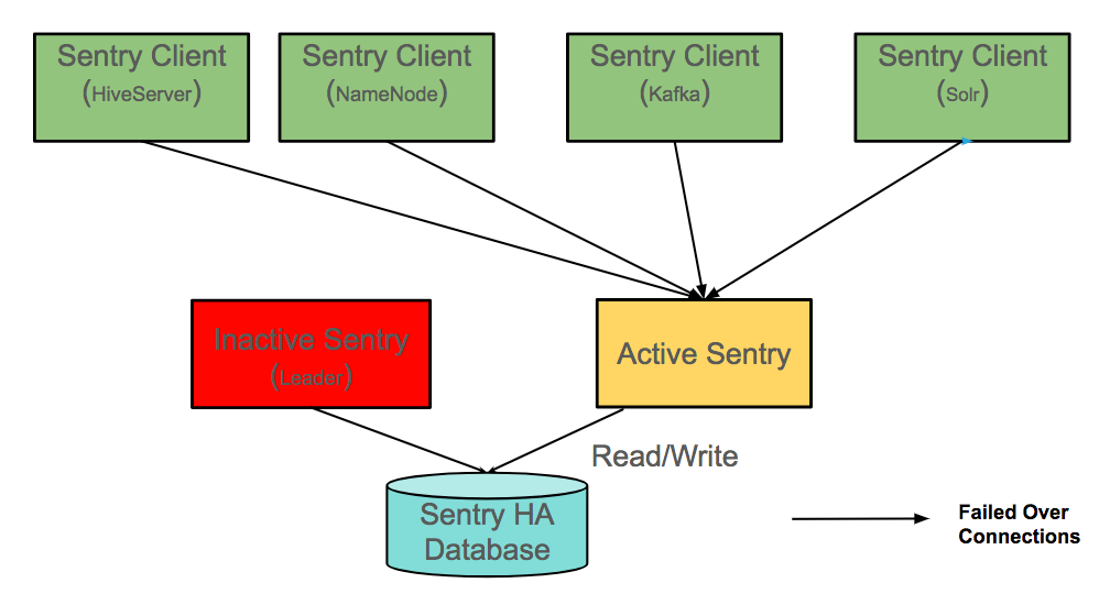

When one of the Sentry Servers is unavailable, as in the following image, the clients connect to the Sentry Server that is available. As the image illustrates, if the leader Sentry Server is unavailable, the other Sentry Server can write to the Sentry database.

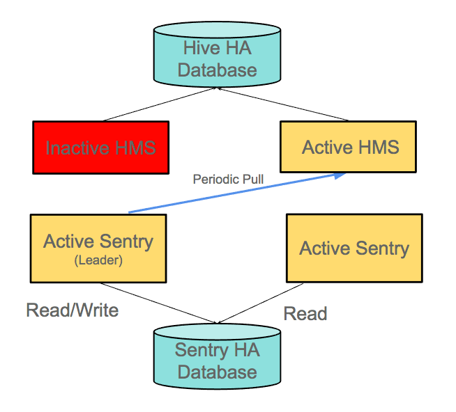

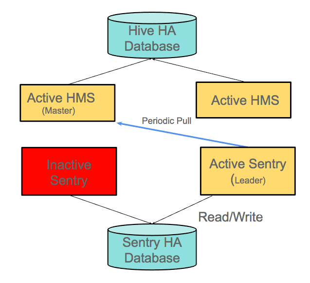

In the image below, one of the Sentry Servers is unavailable. The Sentry Server that is available pulls metadata from the Hive metastore leader.
When one of the Hive metastores is unavailable, the Sentry leader pulls metadata from the metastore that is available, as the following figure illustrates:
