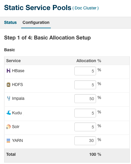

Creating Static Service Pools
Use Static Service Pools to allocate dedicated resources for Impala and other services to allow for predictable resource availability.
Static service pools isolate services from one another, so that high load on one service has bounded impact on other services. You can use Cloudera Manager to configure static service pools that control memory, CPU and Disk I/O.
The following screenshot shows a sample configuration for Static Service Pools in Cloudera Manager:
HDFS always needs to have a minimum of 5-10% of the resources.
- Generally, YARN and Impala split the rest of the resources.
For mostly batch workloads, you might allocate YARN 60%, Impala 30%, and HDFS 10%.
For mostly ad hoc query workloads, you might allocate Impala 60%, YARN 30%, and HDFS 10%.

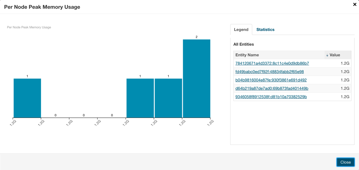

Typically, you set query memory limits using the set MEM_LIMIT=Xg; query option. When you find the right value for your business case, memory-based admission control works well. The potential downside is that queries that attempt to use more memory might perform poorly or even be cancelled.
- Run the workload.
- In Cloudera Manager, go to .
- Click Select Attributes.
- Select Per Node Peak Memory Usage and click Update.
- Allow the system time to gather information, then click the Show Histogram icon to see the results.
- Use the histogram to find a value that accounts for most queries. Queries that require more resources than this limit should explicitly set the memory limit to ensure they can run to
completion.

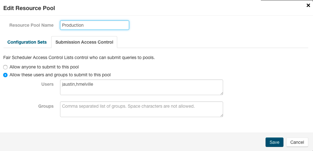

Setting Access Control on Pools
You can specify that only certain users and groups are allowed to use the pools you define.
To create a Development dynamic resource pool for Impala:
- In Cloudera Manager, select .
- Click the Impala Admission Control tab.
- Click the Edit button for the Production pool.
- Click the Submission Access Control tab.
- Select Allow these users and groups to submit to this pool.
- Enter a comma-separated list of users who can use the pool.
- Click Save.
