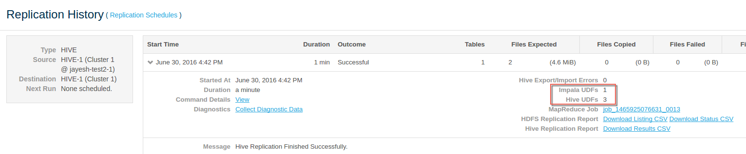

Replication of Impala and Hive User Defined Functions (UDFs)
By default, for clusters where the version of CDH is 5.7 or higher, Impala and Hive UDFs are persisted in the Hive Metastore and are replicated automatically as part of Hive/Impala replications. See User-Defined Functions (UDFs), Replicating Data to Impala Clusters, and Managing Apache Hive User-Defined Functions.

After a replication has run, you can see the number of Impala and Hive UDFs that were replicated during the last run of the schedule on the Replication
Schedules page:
For previously-run replications, the number of replicated UDFs displays on the Replication History page:

Viewing Replication History
You can view historical details about replication jobs on the Replication History page.
To view the history of a replication job:
- Select to go to the Replication Schedules page.
- Locate the row for the job.
- Click .
The Replication History page displays a table of previously run replication jobs with the following columns:
