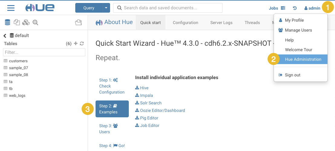

In the top right corner of the page, select <user_name> > Hue Administration > Step 2: Examples

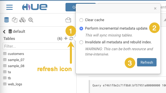

At the top of the page, click Query and then select Editor > Impala to go to the Impala SQL editor, click the refresh icon, select Perform incremental metadata update, and then click Refresh:

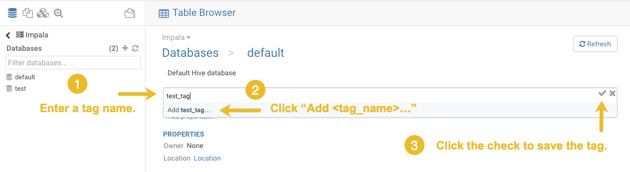

To add a database tag, click Add tags..., enter a tag name in the text box, click Add <tag_name>..., and then click the check on the right to save the tag:

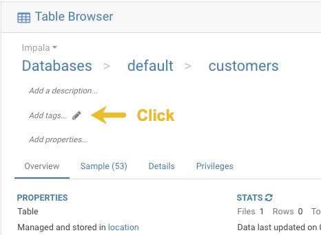

To add a table tag, click the a table name, for example customers, which loads a detail view of the table where you can define a tag:
Click Add tags...:
- Enter a tag name in the text box, click Add <tag_name>..., and then click the check on the right to save the tag. This is the same process you performed for tagging the database in Step 2.

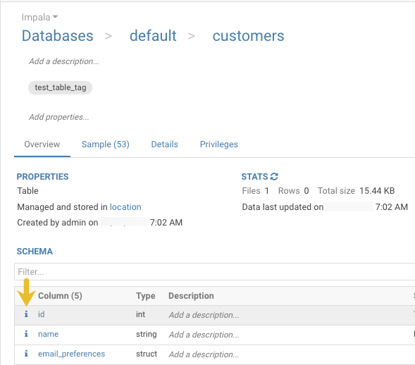

Click the information icon by a column name:
- In the dialog box that opens, click Add tags..., enter a tag name in the text box, click Add <tag_name>..., and then click the check on the right to save the tag.

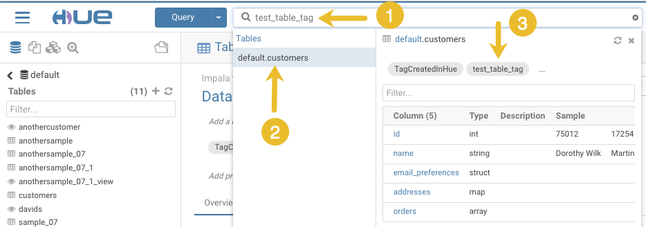

To locate the tags you created, in the metadata search box located just to the right of the Query drop-down menu, type a tag name:
After you type the tag name in the search box, the <database>.<table> where the tag is found is returned. Click the <database>.<table> to view the tags that have been defined for it.
