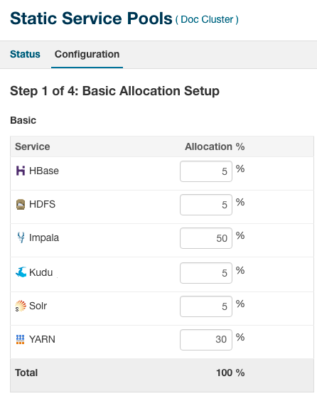

Creating Static Service Pools
Use Static Service Pools to allocate dedicated resources for Impala and other services to allow for predictable resource availability.
Static service pools isolate services from one another, so that high load on one service has bounded impact on other services. You can use Cloudera Manager to configure static service pools that control memory, CPU and Disk I/O.
The following screenshot shows a sample configuration for Static Service Pools in Cloudera Manager:
HDFS always needs to have a minimum of 5-10% of the resources.
- Generally, YARN and Impala split the rest of the resources.
For mostly batch workloads, you might allocate YARN 60%, Impala 30%, and HDFS 10%.
For mostly ad hoc query workloads, you might allocate Impala 60%, YARN 30%, and HDFS 10%.
