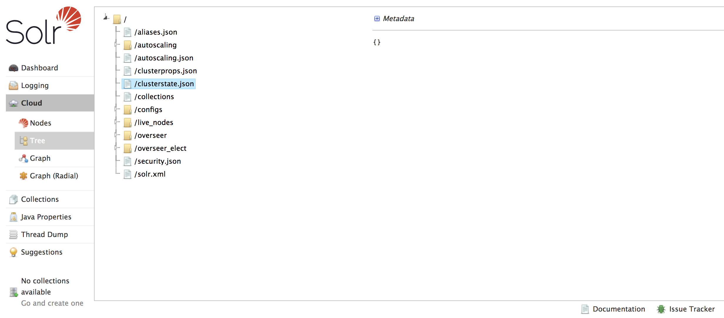

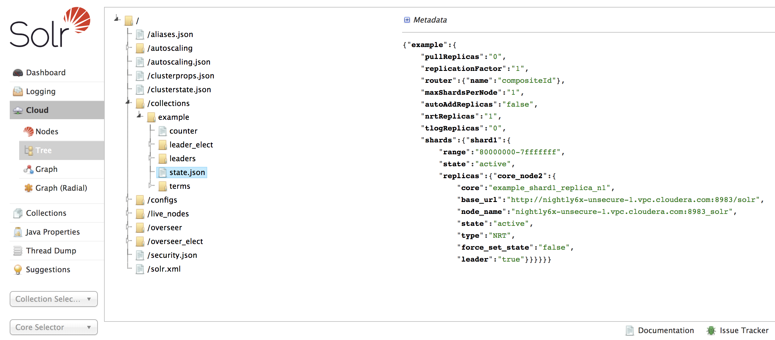

There are three ways to access a collection’s state.json file in CDH 6.
Using the Solr Administration User Interface:- Open the Solr Administration User Interface.
- Click , and expand /collections.
- Open the collection of your choice.
- Select the state.json file. The contents of the file are displayed on the right.

Sample output would be similar to the following.
{"example":{ "pullReplicas":"0", "replicationFactor":"1", "router":{"name":"compositeId"}, "maxShardsPerNode":"1", "autoAddReplicas":"false", "nrtReplicas":"1", "tlogReplicas":"0", "shards":{"shard1":{ "range":"80000000-7fffffff", "state":"active", "replicas":{"core_node2":{ "dataDir":"hdfs://solr01.com:8020/solr/example/core_node2/data/", "base_url":"http://solr01.com.com:8983/solr", "node_name":"solr01.com.com:8983_solr", "type":"NRT", "force_set_state":"false", "ulogDir":"hdfs://solr01.com.com:8020/solr/example/core_node2/data/tlog", "core":"example_shard1_replica_n1", "shared_storage":"true", "state":"active", "leader":"true"}}}}}}[root@solr01 ~]#
