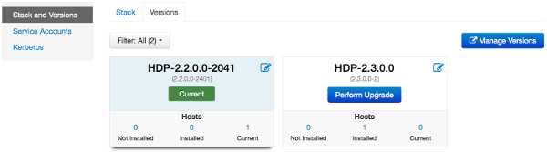

  2. Browse to Admin > Stack and Versions.
  3. Click on the Versions tab.
  4. Under the newly registered and installed version HDP-2.3.0.0, is the actual software repository version in parenthesis (Ambari determined this repository version during the install). For example, in the picture below the display name is HDP-2.3.0.0 and the repository version 2.3.0.0-2. Record this repository version. This is the value of 2.3.x.y-z that you will use later in the upgrade process. Do not click the Perform Upgrade button. You will be performing the upgrade manually instead.
