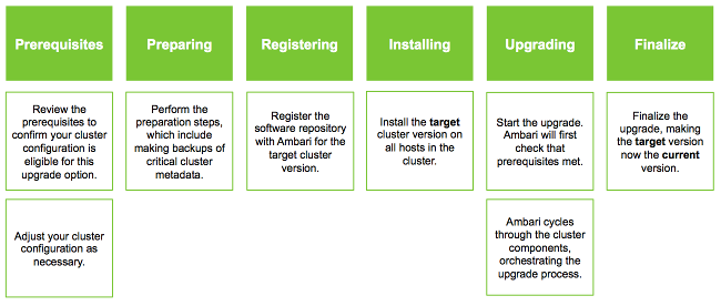

The high-level process for performing an HDP 2.2 -> 2.3 Rolling Upgrade is as follows:
Before upgrading to HDP 2.3, you must first upgrade to Ambari 2.1. Make sure Ambari is upgraded and the cluster is healthy and operating normally prior to attempting to upgrade from HDP 2.2 to HDP 2.3. See Preparing to Upgrade Ambari and HDP for more information on performing the Ambari upgrade. Once you are running Ambari 2.1, follow these steps to upgrade the Stack from HDP 2.2 to HDP 2.3.
  • Prerequisites
  • Preparing to Upgrade
  • Registering a New Version
  • Installing a New Version
  • Performing the Upgrade
