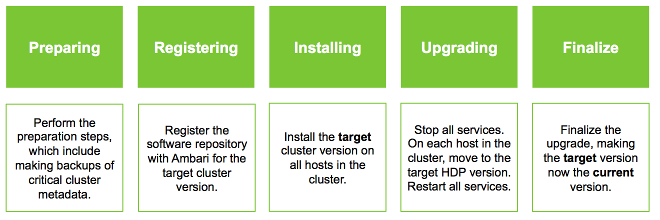

The high-level process for performing an HDP 2.2 -> 2.3 Manual Upgrade is as follows:
Prior to upgrading to HDP 2.3, you must first upgrade to Ambari 2.1. Make sure Ambari is upgraded and the cluster is healthy and operating normally prior to attempting to upgrade from HDP 2.2 to HDP 2.3. See Upgrading Ambari for more information on performing the Ambari upgrade. Once you are running Ambari 2.1, follow these steps to upgrade the Stack from HDP 2.2 to HDP 2.3.
