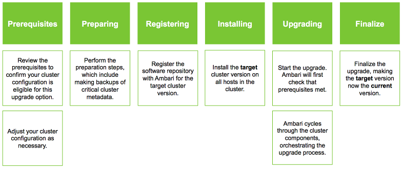

Use this procedure to perform a rolling upgrade from one HDP maintenance release to another. If your cluster is running HDP 2.2 or HDP 2.3, you can perform an upgrade to a later maintenance release of that HDP version. For example: you can upgrade from HDP 2.2.x to HDP 2.2.y OR from HDP 2.3.x to HDP 2.3.y. You are strongly encouraged to read completely through this entire document before starting the upgrade process, so that you understand the interdependencies and order of the steps. It is highly recommended you validate these steps in a test environment to adjust and account for any special configurations for your cluster.
The high-level process for performing a Rolling HDP Maintenance upgrade is as follows:
