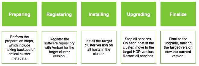

The high-level process for performing a Manual HDP Maintenance upgrade is as follows:
