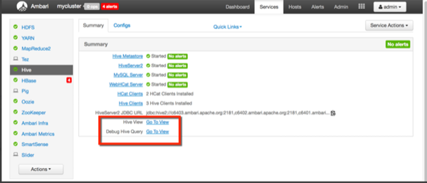

  • Alternatively, you can click a Hive View hyperlink or the Debug Hive Query hyperlink (which opens the Tez View) on the Summary tab when the Hive Service is selected in Ambari:
    Figure 6.2. Links to Hive-Related Views in Ambari
