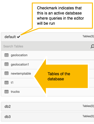

Use the Browse button in the Query Editor to find and select databases. After you select databases and make them active in the view, they appear in the database and table pane.
Figure 6.3. Query Editor
Figure 6.4. Database and Table Pane

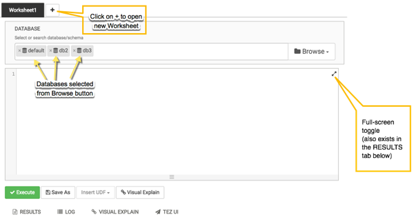

How to Use the Query Editor
  • Enter queries in the blank field. To run a specific query, highlight it, and click Execute. All queries contained in a Worksheet tab execute sequentially, and they run in the same session.
  • Click the Results tab to view the results after a query is exeucuted.
  • Similarly, click the Logs tab to view the log from an executed query.
  • When the first query is executed in a Worksheet, a Tez session is started. Click the Tez UI tab to see details about the DAG execution.
  • Click Save as to save your query.
  • Double-click the Worksheet tab to rename the query, click OK, and then Save as to save the query with the new name.
  • Click on the + symbol to open a new worksheet tab. Queries executed from the new worksheet tab will execute in a different session. Queries from different worksheets can execute in parallel.
  • Click the double arrow icon in the upper right corner of the Query Editor to expand the Worksheet area and cover Database Explorer. Click the icon again to collapse the Worksheet and make Database Explorer available again.
  • Click the icon at the bottom of the Worksheet window and drag it down to expand the authoring space.

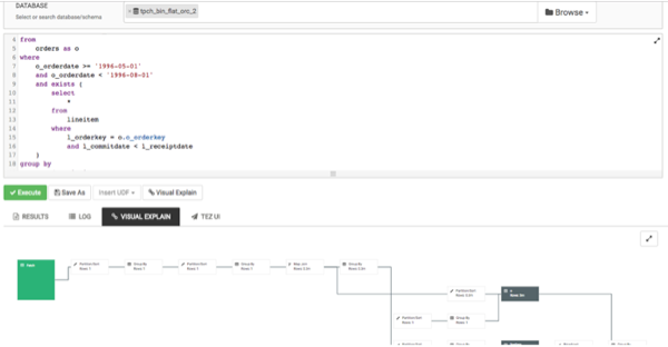

Visual Explain Plan
Hive View 2.0 includes a simple, graphical visualization of the Hive execution plan that focuses on key information that can help you spot expensive operations in your query.
Clicking he Visual Explain tab launches a visual explain plan.
Figure 6.5. SQL in Query Editor with Resulting Visual Explan Plan
The visual explain plan illustrates the execution of the query, regardless of whether you run the query or not. So you can use the Visual Explain feature truly as a planning tool.
[Important]Important
The workflow sequence of the visual explain plan is plotted beginning on the right side and proceeding to the left.
The nodes of the explain plan contain kernels of information that help you forecast or troubleshoot execution problems. Key information of the plan includes:
  • Execution “cost”: The number of processed rows for each node of the visual explain plan is displayed, which gauges the resource demands of the various runtime processes of an executing query.
  • Labeling of runtime processes for easy comparison: Each node is identified by type of operation or process. For example, you can see which nodes represent “cheap” Map Join activity and compare them to “expensive” Partition or Sort operations.
[Tip]Tip
If your query performs Partition or Sort operations on a large number of records, the query runtime is relatively long. In this case, consider tuning or rewriting the query.

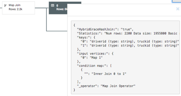

Click on a node to view detailed information about SQL operators:
Figure 6.6. Details of a Map Join Node
