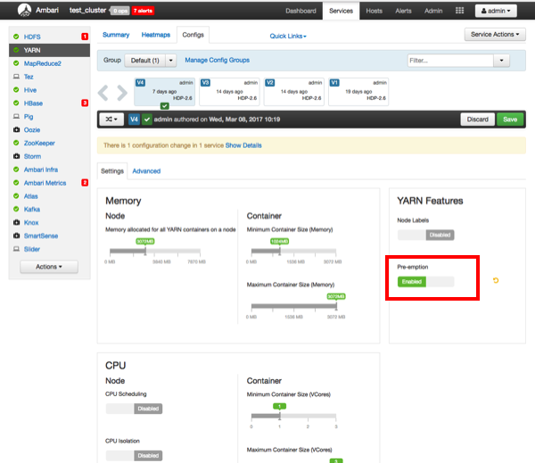

  1. On the Ambari dashboard, select YARN > Configs. Under YARN Features, click Pre-emption. The button label changes to indicate that Preemption is enabled.

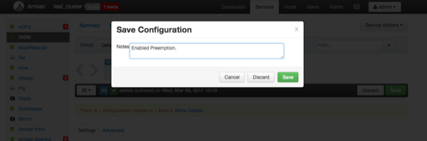

  4. Click Save to save the new configuration settings. On the Save Configuration pop-up, type a description of the changes in the Notes box, then click Save.

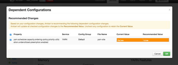

  5. On the Dependent Configurations pop-up, click OK to accept the recommended value of true for the yarn.scheduler.capacity.ordering-policy.priority-utilization.underutilized-preemption.enabled property.

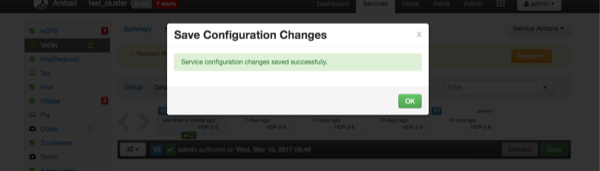

  6. Click OK on the Save Configuration Changes pop-up.

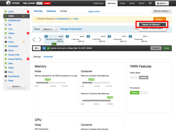

  7. Select Restart > Restart All Affected to restart the YARN service and load the new configuration.

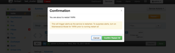

  8. Click Confirm Restart All on the confirmation pop-up to confirm the YARN restart.
