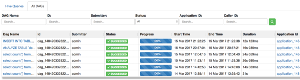

​Identifying the Tez DAG for Your Job
Click All DAGs to view the a list of jobs sorted by time, listing the latest jobs first. You can search for a job using the following search criteria fields:
  • DAG Name
  • Id (DAG identifier)
  • Submitter (user who submitted the job)
  • Status (job status)
  • Application ID (application identifier)
  • Caller ID

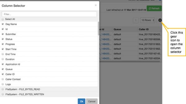

Selecting the Columns That Appear in Search Results
To select which columns are included in the Tez View search results, click the gear icon to the right of the search tool bar. A Column Selector dialog box appears where you can select which columns appear in the search results. Select the columns, and click Ok to return to Tez View:
Figure 11.8. Tez View Column Selector Dialog Box
[Tip]Tip
To search for columns, use the search filter at the top of the Column Selector dialog box. Click Select All to include all columns in your search results and uncheck it to clear all of your column selections.
