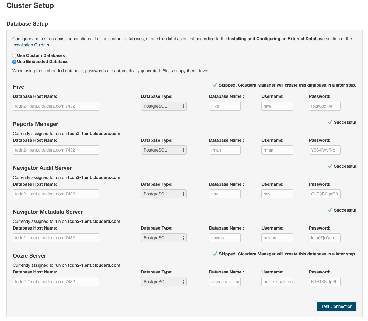

Changing Embedded PostgreSQL Database Passwords
The embedded PostgreSQL database has generated user accounts and passwords. You can see the generated accounts and passwords during the installation process and you should record them at
that time. For example:
