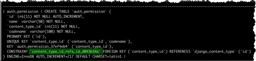

- Drop the foreign key constraint from the auth_permission table in the hue database.
SHOW CREATE table hue.auth_permission; ALTER TABLE hue.auth_permission DROP FOREIGN KEY content_type_id_refs_id_id value;
