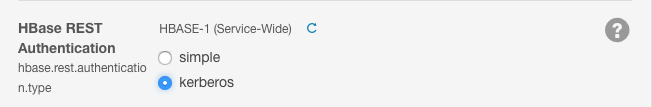

Configure HBase REST Server for Kerberos Authentication
- Log on to Cloudera Manager Admin Console.
- Select .
- Click the Configuration tab.
- Under the Scope filter, click HBase (Service-Wide).
- Under the Category filter, click Security.
- Find the HBase REST Authentication property:
- Click kerberos to select Kerberos instead of simple authentication.
- Click Save Changes.
- Restart the role.
- Restart the service. Select Restart from the Actions drop-down menu adjacent to HBASE-n (Cluster).
