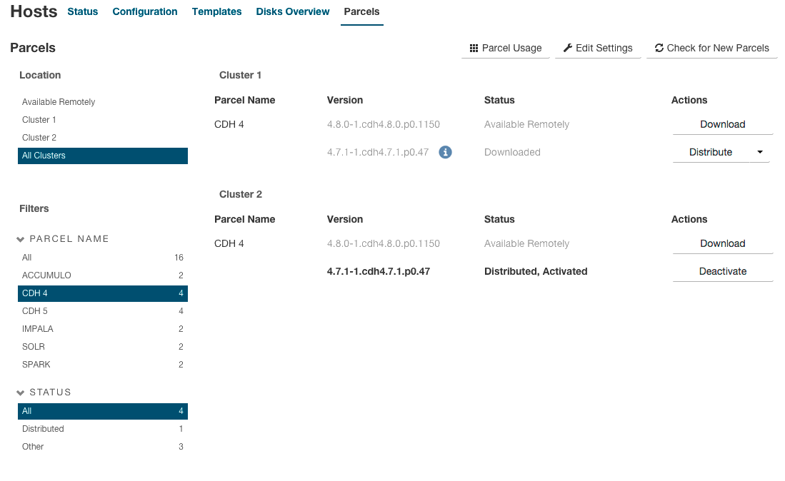

On the Parcels page in Cloudera Manager, you can manage parcel installation and activation and determine which parcel versions are running across your clusters. The Parcels page displays a list of parcels managed by Cloudera Manager. Cloudera Manager displays the name, version, and status of each parcel and provides available actions on the parcel.
Accessing the Parcels Page
- Click the parcel indicator
in the top navigation bar. - Click the Hosts in the top navigation bar, then the Parcels tab.
Use the selectors on the left side of the console to filter the displayed parcels:
- Location selector - View only parcels that are available remotely, only parcels pertaining to a particular cluster, or parcels pertaining to all clusters. When you access the Parcels page, the selector is set to Available Remotely.
- Error Status section of the Filters selector - Limit the list of displayed parcels by error status.
- Parcel Name section of the Filters selector - Limit the list of displayed parcels by parcel name.
- Status section of the Filters selector - Limit the list to parcels that have been distributed, parcels that have not been distributed (Other), or all parcels.
When you download a parcel, it appears in the list for each cluster managed by Cloudera Manager, indicating that the parcel is available for distribution on those clusters. Only one copy of the downloaded parcel resides on the Cloudera Manager Server. After you distribute the parcel, Cloudera Manager copies the parcel to the hosts in that cluster.
For example, if Cloudera Manager is managing two clusters, the rows in the All Clusters page list the information about the parcels on the two clusters. The Status column displays the
current status of the parcels. The Version column displays version information about the parcel. Click the
icon to view the release notes for the parcel. The Actions column shows actions you can perform on the parcels, such as download, distribute, delete, deactivate, and remove from host.
Downloading a Parcel
- Go to the Parcels page. In the Location selector, click ClusterName or Available
Remotely. Parcels that are available for download display the Available Remotely status and a Download button.
If the parcel you want is not shown here—for example, you want to upgrade to a version of CDH that is not the most current version—you can make additional remote parcel repositories available. You can also configure the location of the local parcel repository and other settings. See Parcel Configuration Settings.
If a parcel version is too new to be supported by the Cloudera Manager version, the parcel appears with a red background and error message:
Such parcels are also listed when you select the Error status in the Error Status section of the Filters selector. - Click the Download button of the parcel you want to download to your local repository. The status changes to Downloading.
After a parcel has been downloaded, it is removed from the Available Remotely page.

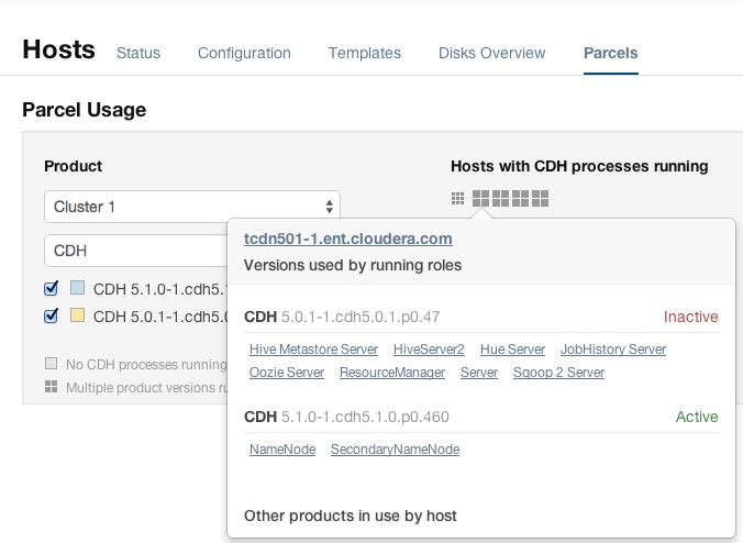

Viewing Parcel Usage
- Do one of the following:
- Click
in the top navigation bar - Click Hosts in the top navigation bar and click the Parcels tab.
- Click
- Click the Parcel Usage button.
This page only shows the usage of parcels, not components that were installed as packages. If you select a cluster running packages, the cluster is not displayed, and instead you see a message indicating the cluster is not running parcels.
You can view parcel usage by cluster or by product.
You can also view just the hosts running only the active parcels, or just hosts running older parcels (not the currently active parcels), or both.
The host map at the right shows each host in the cluster, with the status of the parcels on that host. If the host is running the processes from the currently activated parcels, the host is indicated in blue. A black square indicates that a parcel has been activated, but that all the running processes are from an earlier version of the software. This occurs, for example, if you have not restarted a service or role after activating a new parcel. If you have individual hosts running components installed as packages, the square is empty.
Move the cursor over the
icon to see the rack to which the hosts are assigned. Hosts on
different racks are displayed in separate rows.

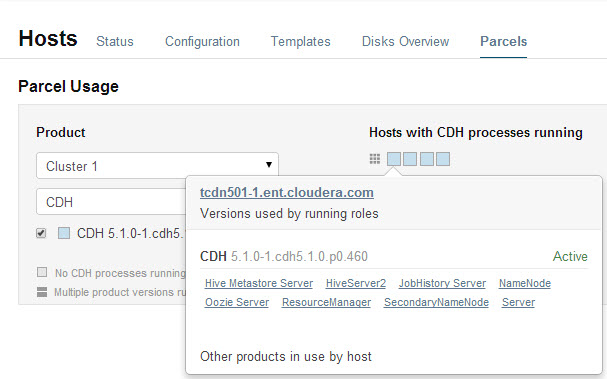

To view the exact versions of the software running on a given host, click the square representing the host. This displays the parcel versions installed on that host.
For CDH 4.4, Impala 1.1.1, and Solr 0.9.3 or higher, the pop-up lists the roles running on the selected host that are part of the listed parcel. Clicking a role opens the Cloudera Manager page for that role. It also shows whether the parcel is active or not.
If a host is running various software versions, the square representing the host is a four-square icon
. When you move the cursor over that host, both the active and inactive components are shown. For example, in the image below, the older CDH parcel has been
deactivated, but only the HDFS service has been restarted.
