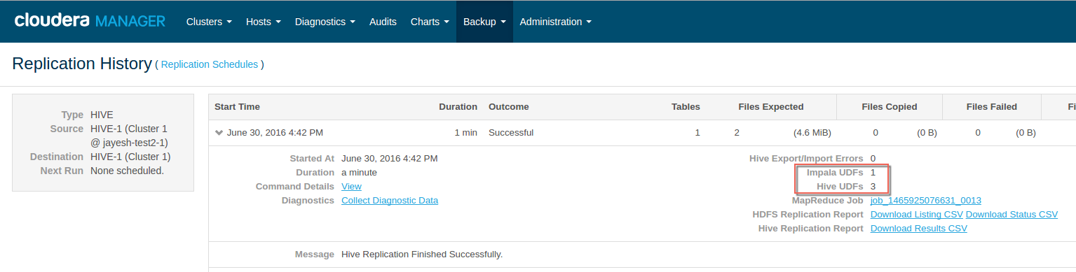

After a replication has run, you can see the number of Impala and Hive UDFs that were replicated during the last run of the schedule on the Replication
Schedules page:
For previously-run replications, the number of replicated UDFs displays on the Replication History page:

Viewing Replication History
You can view historical details about replication jobs on the Replication History page.
To view the history of a replication job:
- Select to go to the Replication Schedules page.
- Locate the row for the job.
- Click .
The Replication History page displays a table of previously run replication jobs with the following columns:

| Files Skipped | Number of files skipped during the replication. The replication process skips files that already exist in the destination and have not changed. |

- Successful. Displays the date and time of the last run replication.
- Failed. Displays the date and time of a failed replication.
- None. This scheduled replication has not yet run.
to expand the display and show details of the replication. In this screen, you can:
