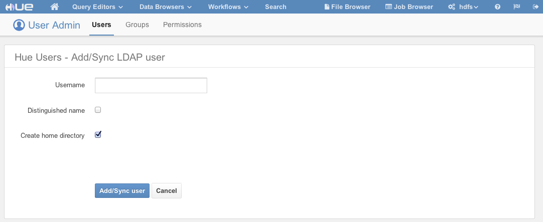

Importing LDAP Users and Groups
If an LDAP user needs to be part of a certain group and be given a particular set of permissions, you can import this user with the User Admin interface in Hue.

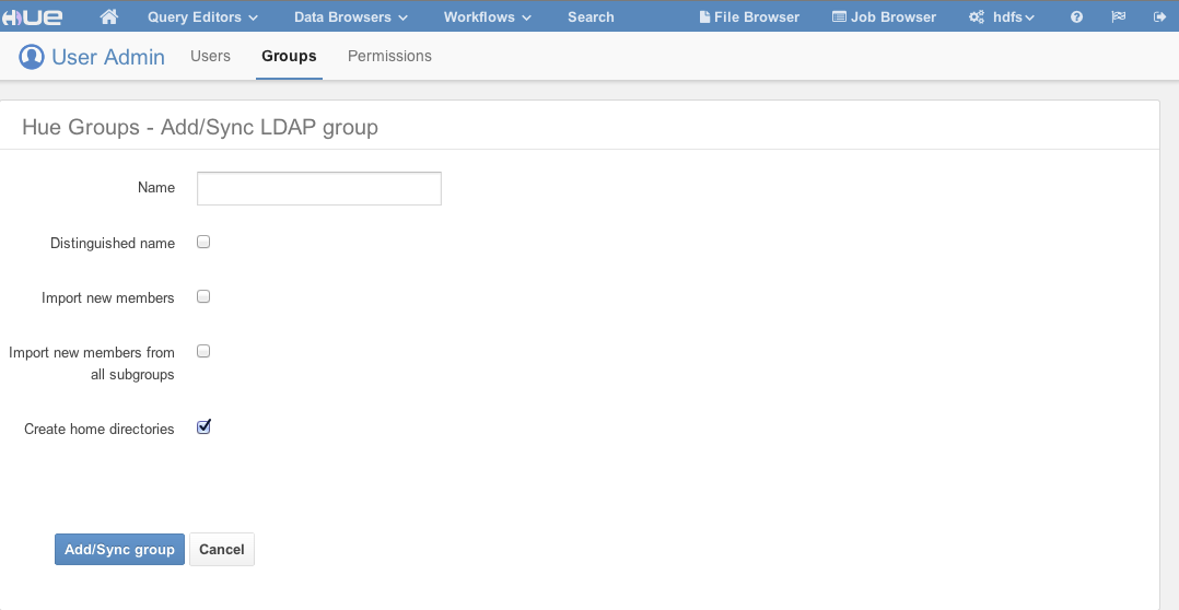

Groups can also be imported using the User Admin interface, and users can be added to this group. As in the image below, not only can groups be discovered using DN and rDN search, but users that are members of the group or members of its subordinate groups can be imported as well.
You have the following options available when importing a user/group:
- Distinguished name: If checked, the username provided must be a full distinguished name (for example, uid=hue,ou=People,dc=gethue,dc=com). Otherwise, the Username provided should be a fragment of a Relative Distinguished Name (rDN) (for example, the username hue maps to the rDN uid=hue). Hue will perform an LDAP search using the same methods and configurations as described above. That is, Hue will take the provided username and create a search filter using the user_filter and user_name_attr configurations.
- Create home directory: If checked, when the user is imported, their home directory in HDFS will automatically be created if it doesn’t already exist.
