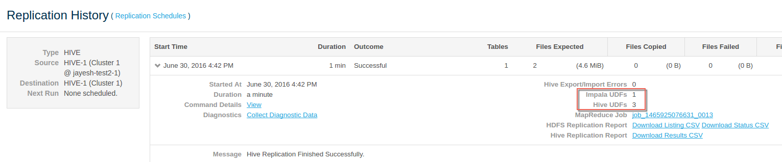

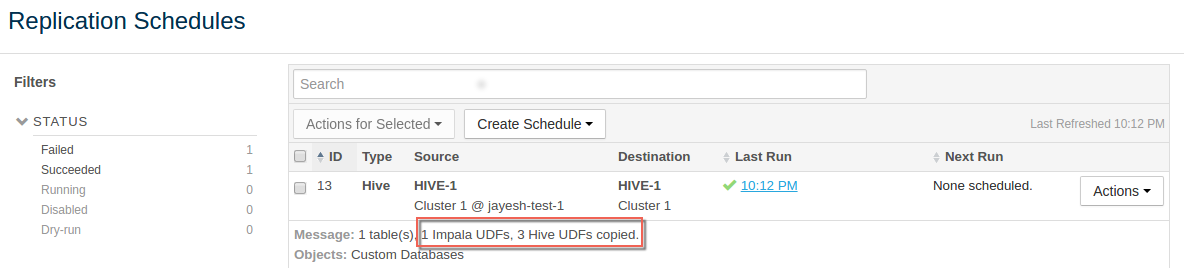

Replication of Impala and Hive User Defined Functions (UDFs)
By default, for clusters where the version of CDH is 5.7 or higher, Impala and Hive UDFs are persisted in the Hive Metastore and are replicated automatically as part of Hive/Impala replications. See User-Defined Functions (UDFs), Replicating Data to Impala Clusters, and Managing Apache Hive User-Defined Functions.
To replicate Impala UDFs when the version of CDH managed by Cloudera Manager is 5.6 or lower, see Replicating Data to Impala Clusters for information on when to select the Replicate Impala Metadata option on the Advanced tab when creating a Hive/Impala replication schedule.
After a replication has run, you can see the number of Impala and Hive UDFs that were replicated during the last run of the schedule on the Replication
Schedules page:
For previously-run replications, the number of replicated UDFs displays on the Replication History page:

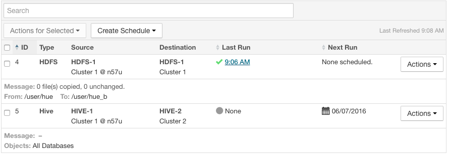

Viewing Replication Schedules
The Replications Schedules page displays a row of information about each scheduled replication job. Each row also displays recent messages regarding the last time the Replication job ran.
Only one job corresponding to a replication schedule can occur at a time; if another job associated with that same replication schedule starts before the previous one has finished, the second one is canceled.
You can limit the replication jobs that are displayed by selecting filters on the left. If you do not see an expected schedule, adjust or clear the filters. Use the search box to search the list of schedules for path, database, or table names.
| Column | Description |
| ID | An internally generated ID number that identifies the schedule. Provides a convenient way to identify a schedule.
Click the ID column label to sort the replication schedule table by ID. |
| Type | The type of replication scheduled, either HDFS or Hive. |
| Source | The source cluster for the replication. |
| Destination | The destination cluster for the replication. |

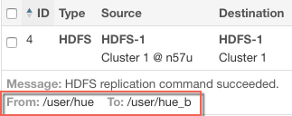

| Objects | Displays on the bottom line of each row, depending on the type of replication:
For example: ![]() |
| Last Run | The date and time when the replication last ran. Displays None if the scheduled
replication has not yet been run. Click the date and time link to view the Replication History page for the replication.
Displays one of the following icons:
Click the Last Run column label to sort the Replication Schedules table by the last run date. |
| Next Run | The date and time when the next replication is scheduled, based on the schedule parameters specified for the schedule.
Hover over the date to view additional details about the scheduled replication.
Click the Next Run column label to sort the Replication Schedules table by the next run date. |
| Actions | The following items are available from the Action button:
- While a job is in progress, the Last Run column displays a spinner and progress bar, and each stage of the replication task is indicated in the message beneath the job's row. Click the Command Details link to view details about the execution of the command.
- If the job is successful, the number of files copied is indicated. If there have been no changes to a file at the source since the previous job, then that file is not copied. As a result, after the initial job, only a subset of the files may actually be copied, and this is indicated in the success message.
- If the job fails, the
icon displays. - To view more information about a completed job, select . See Viewing Replication History.

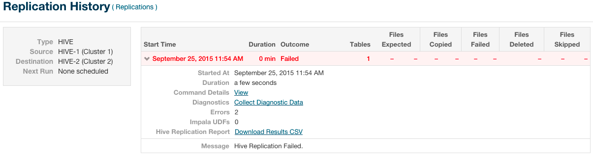

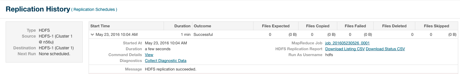

You can view historical details about replication jobs on the Replication History page.
To view the history of a replication job:
- Select to go to the Replication Schedules page.
- Locate the row for the job.
- Click .
The Replication History page displays a table of previously run replication jobs with the following columns:
| Start Time | Time when the replication job started.
Expand the display and show details of the replication. In this screen, you can:
