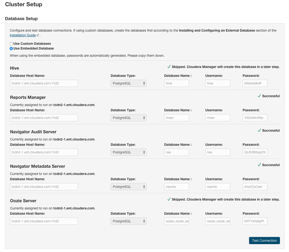

Configure Database Settings
Keep the default setting of Use Embedded Database to have Cloudera Manager create and configure required databases. Record the auto-generated
passwords.
- Click Test Connection. When all the tests are successful the Continue button turns blue.
- Click Continue. The Cluster Setup Review Changes screen displays.
