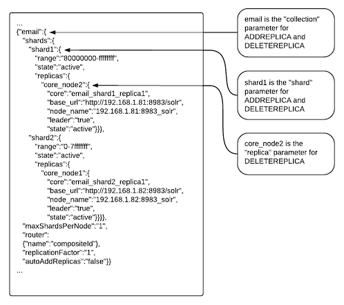

- Use the CLUSTERSTATUS API call to retrieve information about the cluster, including current cluster status:
http://solr01.example.com:8983/solr/admin/collections?action=clusterstatus&wt=json&indent=true
Review the returned information to find the correct replica to remove. An example of the JSON file might appear as follows:
- Delete the old replica on solr01.example.com server using the DELETEREPLICA API call:
http://solr01.example.com:8983/solr/admin/collections?action=DELETEREPLICA&collection=email&shard=shard1&replica=core_node2
