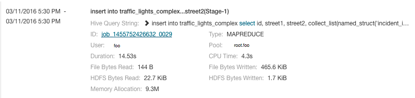

Results Tab
Jobs are ordered with the most recent at the top. Each job has summary and detail information. A job summary includes start and end timestamps, query (if the job is part of a Hive query)
name, pool, job type, job ID, and user. For example:
A running job displays a progress bar under the start timestamp:

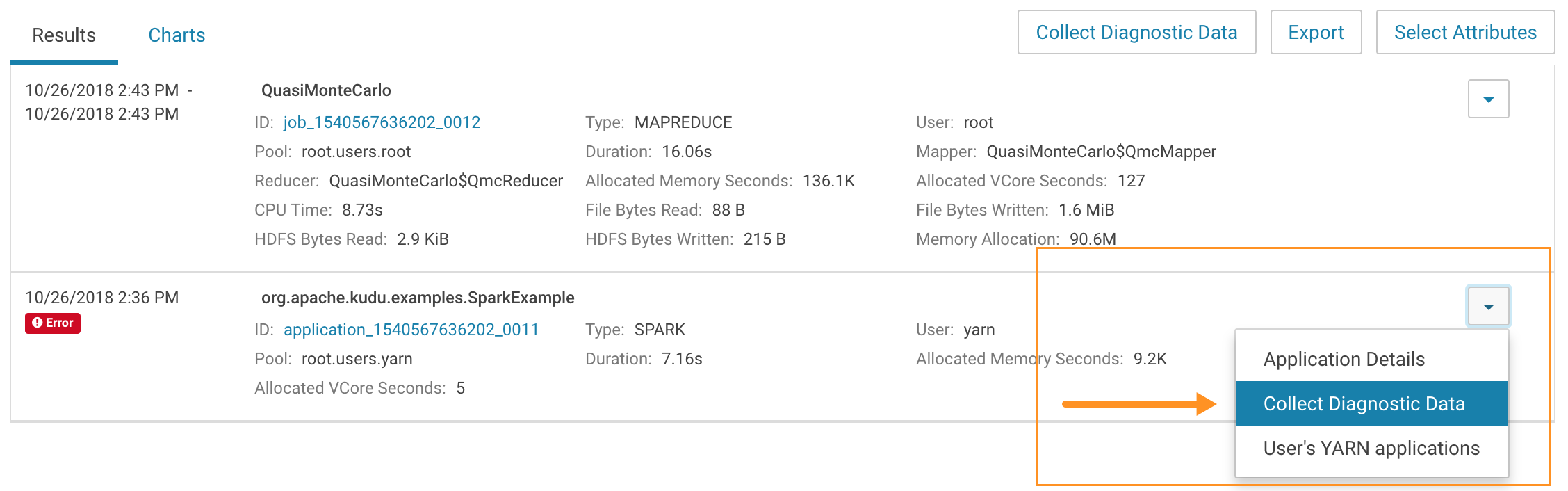

to the right of each job listing to do the following. (Not all
options display, depending on the type of job.)
- Application Details – Open a details page for the job.
- Collect Diagnostic Data – Send a YARN application diagnostic bundle to Cloudera support.

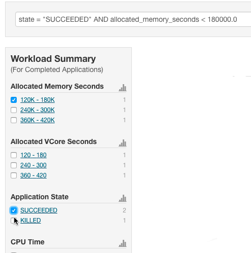

Choosing and Running a Filter
- Do one of the following:
- Select a Suggested or Recently Run Filter
Click the
to the right of the Search button to
display a list of sample and recently run filters, and select a filter. The filter text displays in the text box. - Construct a Filter from the Workload Summary Attributes
Optionally, click Select Attributes to display a dialog box where you can chose attributes to display in the Workload Summary section. Select the checkbox next to one or more attributes and click Close. Only attributes that support filtering appear in the Workload Summary section. See the Attributes table.
The attributes display in the Workload Summary section along with values or ranges of values that you can filter on. The values and ranges display as links with checkboxes. Select one or more checkboxes to add the range or value to the query. Click a link to run a query on that value or range. For example:

Minimum Required Role: Cluster Administrator (also provided by Full Administrator)
- From the YARN page in Cloudera Manager, click the Applications menu.
- Collect diagnostics data. There are two ways to do this:
- To collect data from all applications that are visible in the list, click the top Collect Diagnostics Data button on the upper right, above the list of YARN applications.
- To collect data from only one specific application, click the down arrow on the right-hand end of the row of the application and select Collect Diagnostics Data.
- In the Send YARN Applications Diagnostic Data dialog box, provide the following information:
- If applicable, the Cloudera Support ticket number of the issue being experienced on the cluster.
- Optionally, add a comment to help the support team understand the issue.
- Click the checkbox Send Diagnostic Data to Cloudera.
- Click the button Collect and Send Diagnostic Data.
