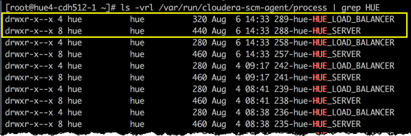

Cloudera Manager logs the starting and stopping of each supervised Hue process in standard stream logs (stdout.log, stderr.log).
ls -vrl /var/run/cloudera-scm-agent/process | grep HUE
It writes to a nested logs directory for each running instance:
Configuration errors are written here because they prevent Hue servers and load balancers from starting properly.

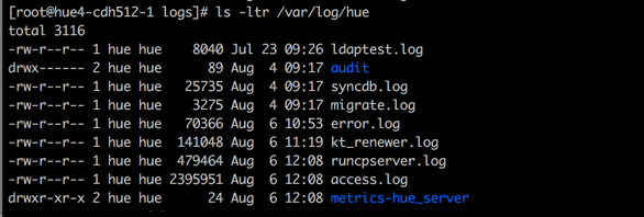

Hue Service Django Logs
Log Name |
Description |
| access.log | Filtered list of successful attempts to access Hue Web UI |
| audit.log | Audit log visible in Cloudera Navigator |
| collectstatic.log | Static files that support Hue Web UI (images, JavaScript files, CSS, ...) |
| error.log | Filtered list of all nontrivial errors |
| kt_renewer.log | Kerberos ticket renews |
| metrics_hue_server.log | Populates charts in Cloudera Manager |
| migrate.log | Database and table migrations + First Run of Hue server |
| runcpserver.log | Hue (CherryPy) web server info (CP server runs Django core) |
| syncdb.log | Database and table creations |
Enable DEBUG
DEBUG is available for the Hue Django logs in /var/log/hue.
By default, the Hue service writes INFO level messages and keeps a small buffer of log messages at all levels in memory.
- Cloudera Manager: Go to , check Enable Django Debug Mode, and .
- Hue Web UI: Go to the Home page, select Server Logs, and check Force Debug Level. Debug is enabled on-the-fly.

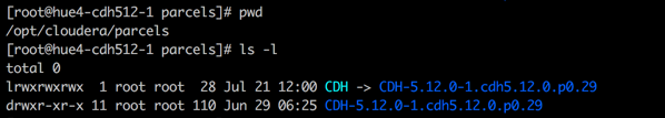

$HUE_HOME
- For package installs, this is usually /usr/lib/hue/
- For parcel installs, this is usually, /opt/cloudera/parcels/CDH/lib/hue/
ls -l /opt/cloudera/parcels
You can Run Hue Shell Commands from this location.
Hue Role Instance Process Directories
cd /var/run/cloudera-scm-agent/process/`ls -valrt /var/run/cloudera-scm-agent/process | grep HUE_SERVER | tail -1 | awk '{print $9}'`
cd /var/run/cloudera-scm-agent/process/`ls -valrt /var/run/cloudera-scm-agent/process | grep HUE_LOAD | tail -1 | awk '{print $9}'`Hue Server Configuration Files
