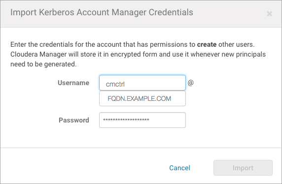

Step 3: Add the Credentials for the Principal to the Cluster
- Log in to the Cloudera Manager Admin Console.
- Select .
- Click the Kerberos Credentials tab.
- Click the Import Kerberos Account Manager Credentials button.
- Enter the credentials for the principal added to the Kerberos KDC in the previous step:
- For Username, enter the primary and realm portions of the Kerberos principal. Enter the realm name in all upper-case only (YOUR-REALM.EXAMPLE.COM) as shown below.
- Enter the Password for the principal.
- Click Import.
Cloudera Manager encrypts the username and password into a keytab and uses it to create new principals in the KDC as needed.
Click Close when complete.

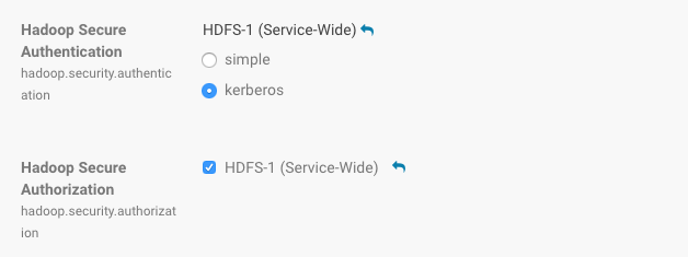

Step 6. Specify Kerberos for Security
Kerberos must be specified as the security mechanism for Hadoop infrastructure, starting with the HDFS service. Enable Cloudera Manager Server security for the cluster on an HDFS service. After you do so, the Cloudera Manager Server automatically enables Hadoop security on the MapReduce and YARN services associated with that HDFS service.
In the Cloudera Manager Admin Console:
- Select .
- Click the Configuration tab.
- Select HDFS-n for the Scope filter.
- Select Security for the Category filter.
- Scroll (or search) to find the Hadoop Secure Authentication property.
- Click the kerberos button to select Kerberos:
- Click the value for the Hadoop Secure Authorization property and select the checkbox to enable service-level authorization on the selected HDFS
service. You can specify comma-separated lists of users and groups authorized to use Hadoop services or perform admin operations using the following properties under the Service-Wide Security section:
- Authorized Users: Comma-separated list of users authorized to use Hadoop services.
- Authorized Groups: Comma-separated list of groups authorized to use Hadoop services.
- Authorized Admin Users: Comma-separated list of users authorized to perform admin operations on Hadoop.
- Authorized Admin Groups: Comma-separated list of groups authorized to perform admin operations on Hadoop.
- In the Search field, type DataNode Transceiver to find the DataNode Transceiver Port property.
- Click the value for the DataNode Transceiver Port property and specify a privileged port number (below 1024). Cloudera recommends 1004.
- In the Search field, type DataNode HTTP to find the DataNode HTTP Web UI Port property and specify a privileged port number (below 1024). Cloudera recommends 1006.
- In the Search field type Data Directory Permissions to find the DataNode Data Directory Permissions property.
- Reset the value for the DataNode Data Directory Permissions property to the default value of 700 if not already set to that.
- Make sure you have changed the DataNode Transceiver Port, DataNode Data Directory Permissions and DataNode HTTP Web UI Port properties for every DataNode role group.
- Click Save Changes to save the configuration settings.
